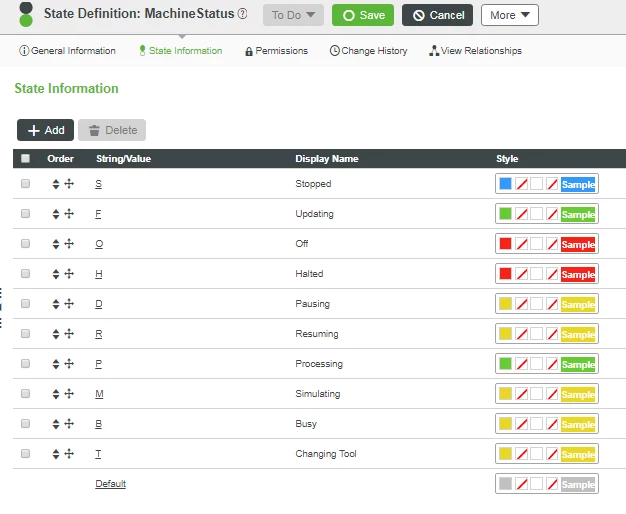

Hi. Im trying to display a label based on a state. To achieve this I decided to create the next State Definition;
(Check attached image 1)

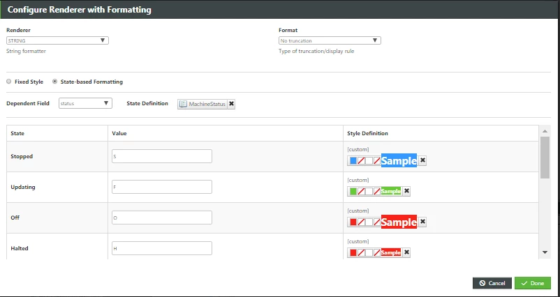

In the mashup that shows the value (with a ValueDisplay) I specify the state definition in the valueformat.
(Check attached image 2)
But, even when i do this, in the mashup still showing the value instead the Display String..  I also defined the labels on the widget, but it doesn't change anything..

That display string probably would work for the 'button bar' but doesn't work in general for state based definitions.
So you may have to create images per state that show/read the way you want.
