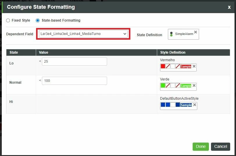

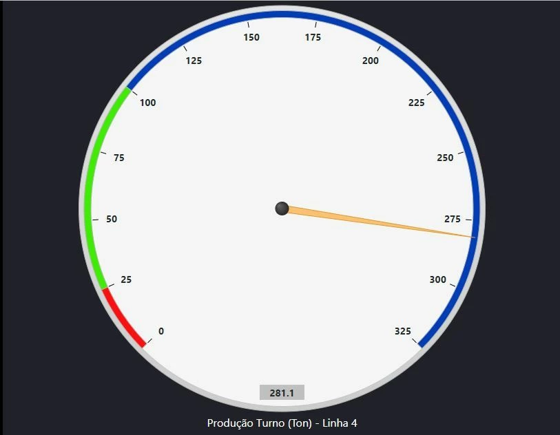

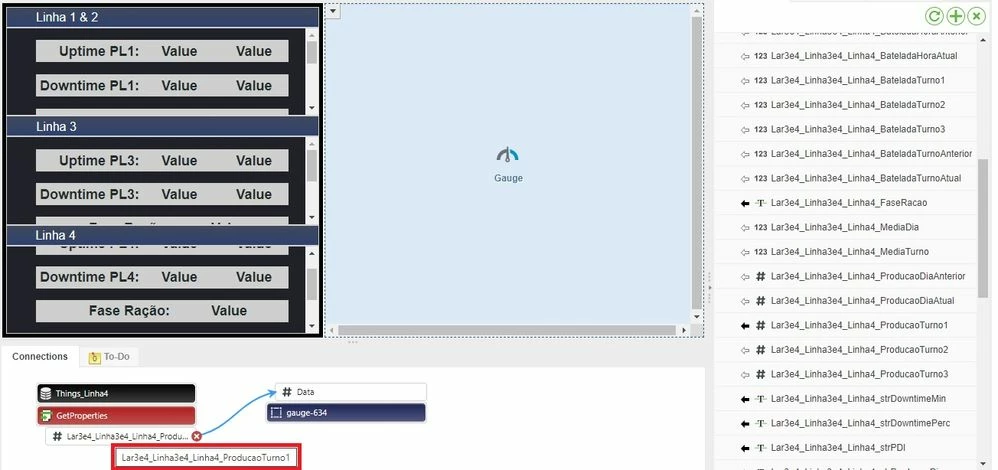

I follow this steps:
1 - Binded my variable to show the value on field "Data" from gauge;
2 - Binded my variable to control the color of gauge into the propertie "ValueFormatter";
It looked like this:
I would like to show the value but to control the color of gauge through of another variable.
