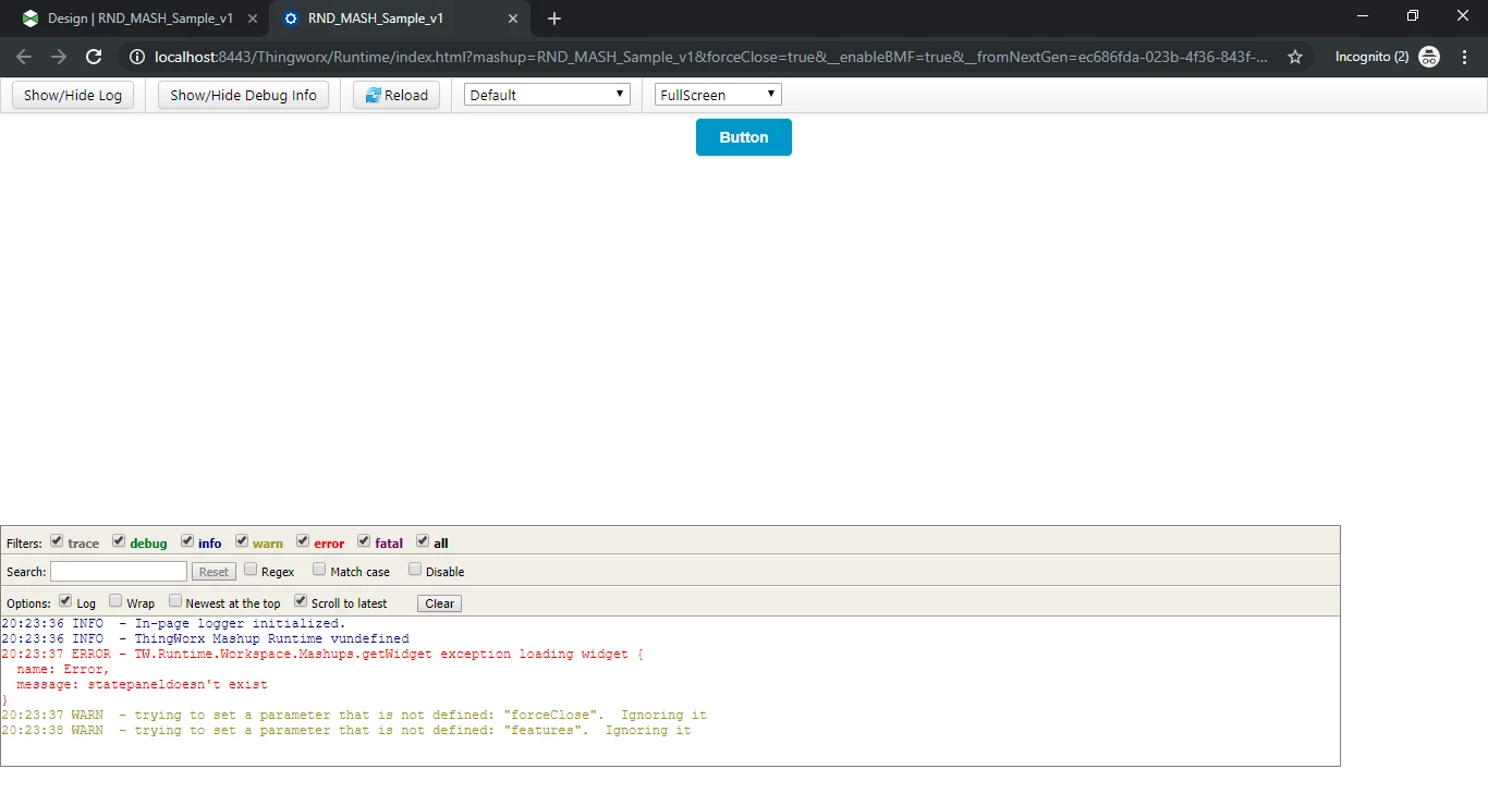

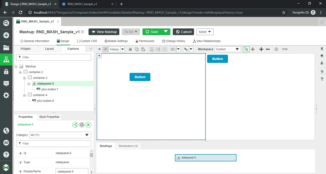

Hi Team,
I am facing an issue in that state panel doesn't exist in the runtime. The widgets in the state panel does not show it.
I have attached the Design time and Runtime Screen Shot with Log.
The Error Message Shown in the runtime
ERROR - TW.Runtime.Workspace.Mashups.getWidget exception loading widget { name: Error, message: statepaneldoesn't exist }

Hi @mervinnobelraj.
The statepanel widget appears to be custom.  If this was designed by someone within your company, you may need to track down the source to determine the proper use and configuration.

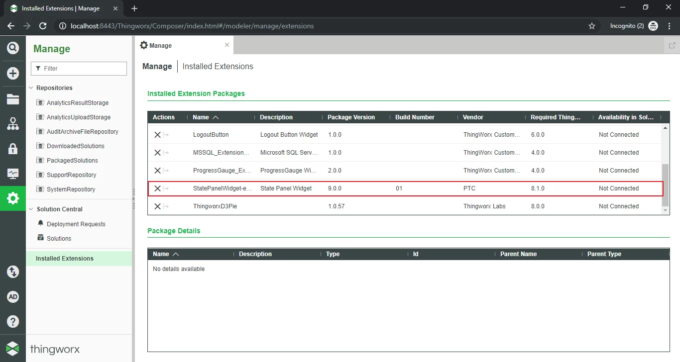

Hi @slangley
This widget i have downloaded from the ptc support Portal and it was developed by the ptc.

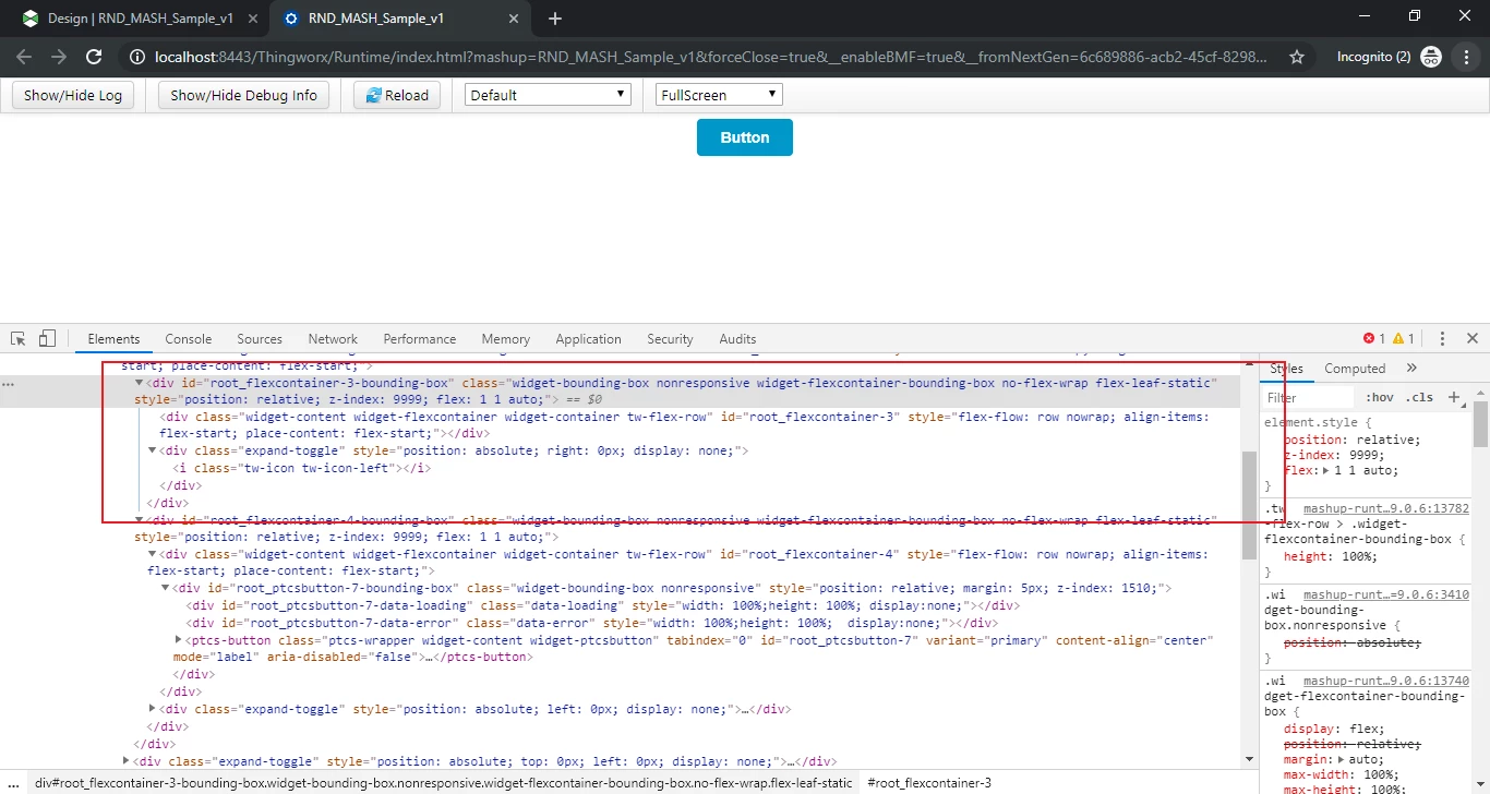

Hi @BABA-SHYAM ,
I have tried that CSS code you have shared but in the Html hierarchy itself I can't find that element of the state panel for reference i attached the screen shot.

Support
Hi @mervinnobelraj.
Which version of ThingWorx are you running?  When did you download the State Panel widget?
I checked when you first posted this topic and could not find the State Panel widget on the PTC Support downloads page nor on the PTC Marketplace.  I also found nothing in the Help Center about it.
Regards.
--Sharon
Support
Hi @mervinnobelraj.
Since the State Panel widget you have installed is apparently not available any longer, we have no information on which ThingWorx versions it is compatible with.  What version of ThingWorx are you running?
Regards.
