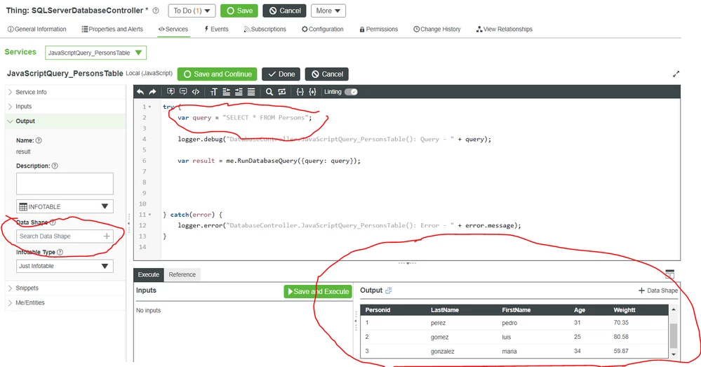

I'm pretty new with thingworx and I need to develop mashups that read/write data from/to SQLServer and handle some of that data to do custom reports
So, I have some troubles to store sql results in a database entity to use in the example mashup that I've been working
what I did was:

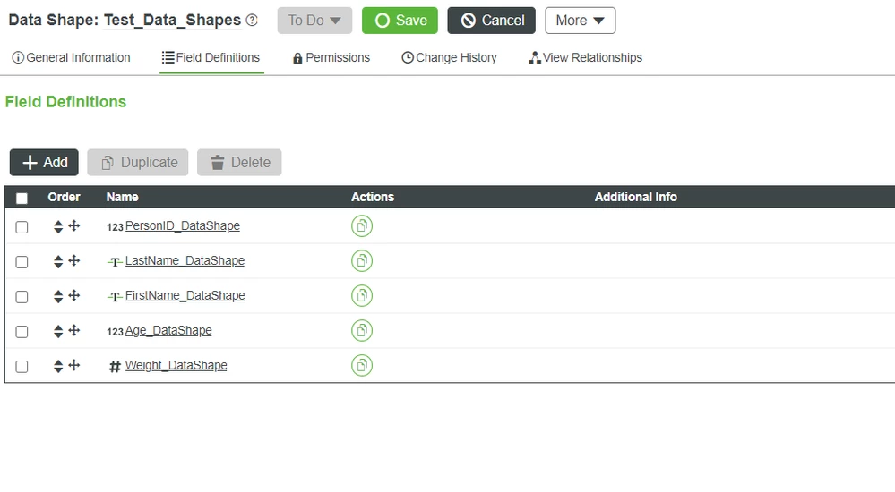

- Create a test data shape with the sql table structure:Test_Data_Shape.PNG

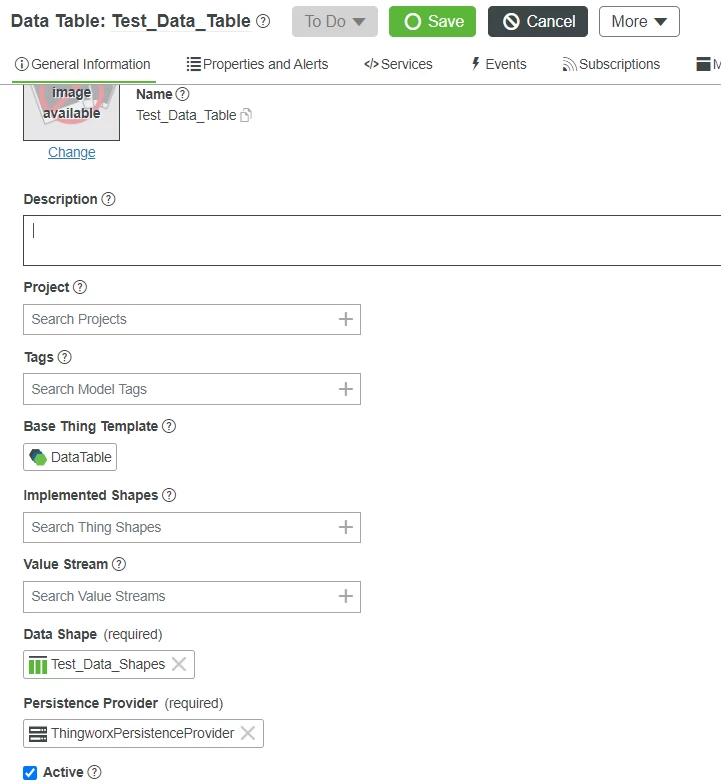

- Create a test data table with the adding the shapes I just create:
- Create a Database Thing that make the connection to SQL server and in a javascript do the query.... you'll se the results down (I also tryied to set the test data shape in the output and nothing)

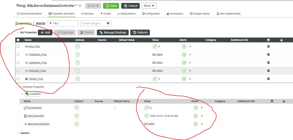

- In the database thing I also added properties
From there I'm lost, I don;t know how to set the properties with the data returned
Can you help me with some code to base on, so I can store the values in the properties and display in a widget (can be a grid for start) in the mashup?
I've been looking for some complete examples and until now I haven't found any...

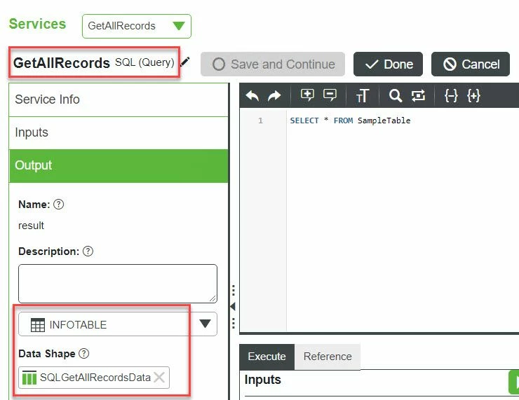

1. Create a database thing (in my demo, the name is ACMESQLDatabase ) as you have done
2. Create a services  GetAllRecords:
  1. Select SQL (Query).
  2. Type SELECT * FROM SampleTable in the Script text field.
3. Refer below steps to create the related database based the outputs of GetAllRecords services:
  1. Click the Test button for the GetAllRecords service.
  2. Click the Execute Query button.
  3. Click the + DataShape  button to create datashape:
    4. Type SQLGetAllRecordsData in the Name field and save the datashape (the properties in Filed Definitions will be generated automatically based on the sql result)
4. Configure the GetAllRecords service to return an InfoTable that uses the new DataShape as below:

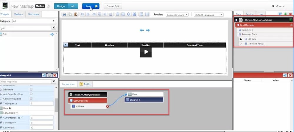

  4. Task 4. Load the service data into a Grid widget.
    1. Type G in the Filter Widgets field.
    2. Drag a Grid widget from the Widgets panel to the bottom row of the layout area.
    3. Drag All Data from the Data panel to the grid.
    4. Select Data as the Binding Target.

6. Click the View Mashup button of the mashup and check the data values.

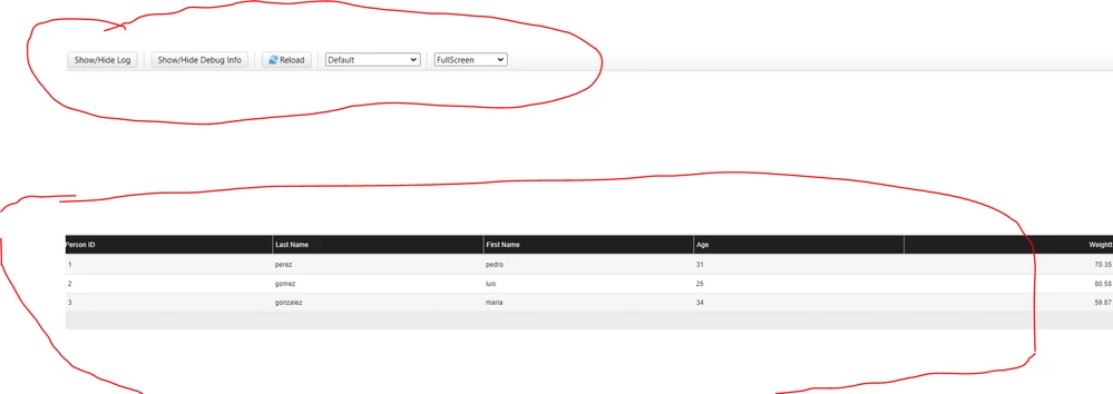

1) How do I hide or remove the top tool bar?
2) Do I need other services if I need data to fill a List or a Graph?
3) Is there a site where I can find examples just like yours?
4) Can you share your full code example with me? I'm interested to test the insert / update / delete records as you mentioned...
Best Regards,
Marcos
October 29, 2020
@MM_9665428
Please refer below:
There are two ways to hide the debugging tool bar on Mashup
  1. Remove "&__fromNextGen=xxx" part from URL on browser and reload a Mashup page
  2. Press Ctrl+Alt+F9 on a Mashup page

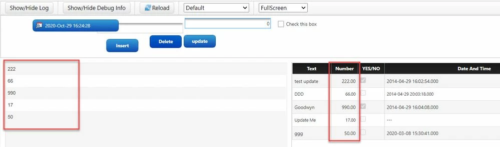

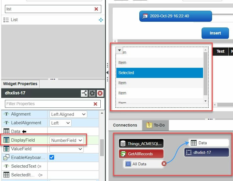

The demo I provided is using one services to fill the grid. Whether it need other services it depends on what data you would like to fill a List or Graph.
For example as below I still use the same service which I have used for Grid to fill the list with the Number got from the service:

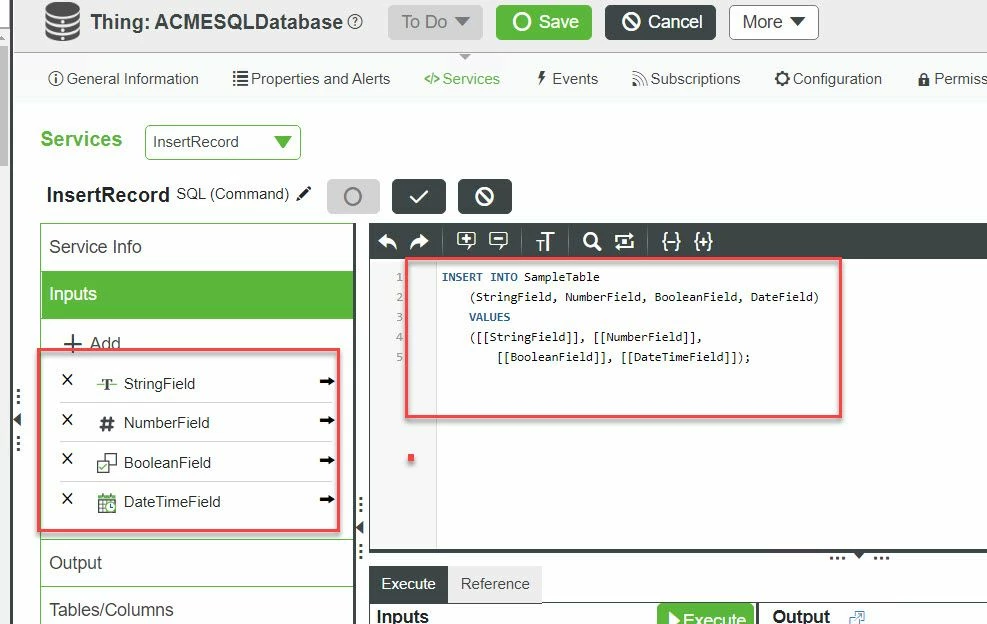

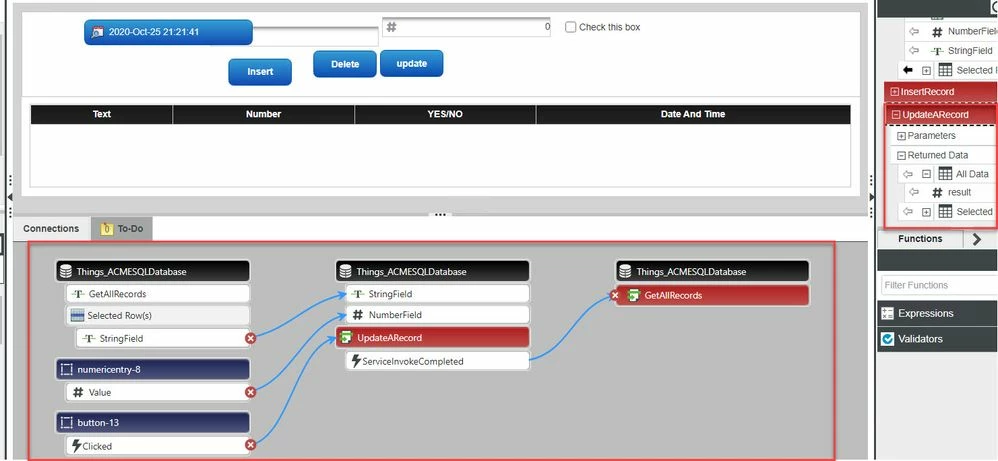

4) Can you share your full code example with me? I'm interested to test the insert / update / delete records as you mentioned...:
Insert code demo as below based on my previous post example scenario for you:
Best Wishes!
