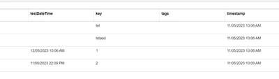

I think it is not possible to store DateTime value in 12 hours format but while displaying you can convert it to 12 hours format and display it
Something like this

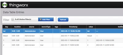

Actual value stored in DataTable

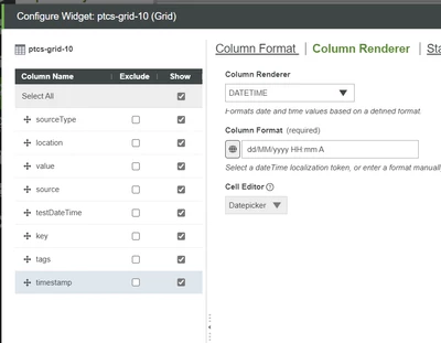

You need to specify DateTime format in Grid Column Renderer configuration (if you are going to display in Grid)
