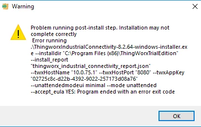

I've been installing ThingworxTrial and faced a strange error for which I could not find any resource.
Config & install steps: Window10 64bits, 2 CPUs-10GB of ram & 50 GB of storage allocated to on docker, DockerMachinePTC is the only VM, Hyper-V enabled, VirtualBox DHCP IP range set, no other app uses port 8080.
The error message, install.log, ThingWorx Industrial Connectivity 8.log, Thingworx Industrial Connectivity-install.log are attached.

Installing ThingWorx Industrial Connectivity ...
Executing .\ThingworxIndustrialConnectivity-8.2.64-windows-installer.exe --installdir "C:\Program Files (x86)\ThingWorxTrialEdition" --install_report "thingworx_industrial_connectivity_report.json" --twxHostName "10.0.75.1" --twxHostPort "8080" --twxAppKey "02725c8c-d22b-4392-9022-257173d08a76" --unattendedmodeui minimal --mode unattended --accept_eula YES
Script exit code: 1
Script output:
There has been an error.
Failed to execute installation action for Thingworx Industrial Connectivity
Script stderr:
Program ended with an error exit code
Error running .\ThingworxIndustrialConnectivity-8.2.64-windows-installer.exe --installdir "C:\Program Files (x86)\ThingWorxTrialEdition" --install_report "thingworx_industrial_connectivity_report.json" --twxHostName "10.0.75.1" --twxHostPort "8080" --twxAppKey "02725c8c-d22b-4392-9022-257173d08a76" --unattendedmodeui minimal --mode unattended --accept_eula YES: Program ended with an error exit code
Problem running post-install step. Installation may not complete correctly
[16:44:32] - Rolling back installation: docker_label = TWX...

Thank you for your post.  Are you seeing this error when running ThingWorxIndustrialConnectivity.exe version 6.5.829.0?
