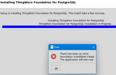

Stuck at Thingworx Foundation install on RHEL
Trying to get a simple dev instance install on my RHEL 9 system. Installer keeps failing at the "cinc-client -z --config". I have ready through the following article which discuss this at length.
https://www.ptc.com/en/support/article/CS329897?source=search (note this does say SQLServer and I am using postgres)
I do have JAVA_HOME setup properly and running OpenJDK 21
openjdk version "21.0.7" 2025-04-15 LTS
OpenJDK Runtime Environment Corretto-21.0.7.6.1 (build 21.0.7+6-LTS)
OpenJDK 64-Bit Server VM Corretto-21.0.7.6.1 (build 21.0.7+6-LTS, mixed mode, sharing)
I am not using a complex DB password with special characters initially. Not using SSL as this is simple dev system. I tried my own folder AND /opt folder with no change. I did have to preinstall CINC so cinc-18.5.0-1.el9.x86_64.rpm was loaded first and this appears ok from my past installs.
Here is where I might not be following things exactly but if I knew was the issue was, I can work to solve it. The log file that it generates when running cinc-client gets deleted along with the whole installation folder before I have a chance to view it. How am I supposed to find the true error?
<thingworx_installation_folder>\installer\logs\foundation-YYYYMMDDhhmmss.log
Running less that ideal resources: Yes, I know this but if that is not the issue, ok to run with less, this is dev.
RHEL 9.2 - Yes, I think 9.7.0 requires 9.4. Again, I have another installed running in 9.2 so if its not the issue, ok to vary here.
SELinux - Running in permissive mode so this should not be an issue.
Anything else that could be the cause? Any way I can capture these logs before installer deletes them?

To preserve a log file you can watch the directory via inotifywait, and when it gets created, just create a hard link to it (ln $logfile backup.txt, note no -s).

Thank you that was very helpful trick to capture the logs. It did confirm a suspicion that this was SELinux related. Pointed me to this article which described the error that was reported: https://www.ptc.com/en/support/article/CS386968?source=search
I made that modification and reran now with some new error message. Reminds me of my post from a few months ago.
Tomcat failed to start on ThingWorx Install 9.7. Installer bailed and removed ThingWorx
Same issues different day. We need better support for SELinux, better documentation and better installers.
