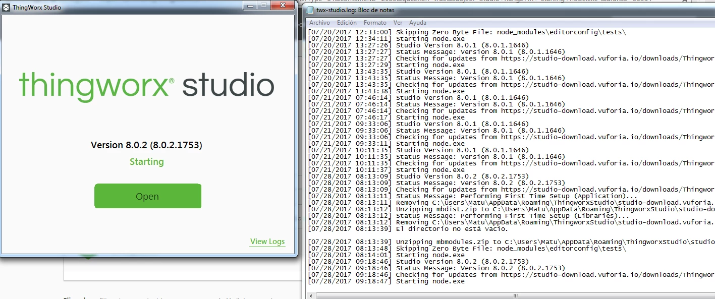

I have tried to install thingworx studio in 2 different computer with windows 7 (32 bits) and in both the software hangs in "starting node.exe" in log, and the in the screen in "starting", and the button "open" is not active.
Any idea?
Thank you.
Message was edited by: Sushant Pandey moving to ThingWorx Studio
    July 28, 2017

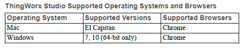

    Francisco Javier Martinez Maturana​: At present, ThingWorx Studio is only supports for 64-bit Windows OS. Please find supported system as below and let us know if you still have issues with supportable OS.
