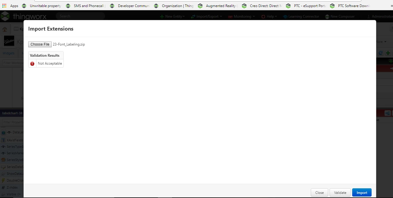

I am using Thingworx version 8.1
I downloaded this extension but on importing the validation says not acceptable.
Does this widget supports only v 8.2?
V Shalini.
May 28, 2018
The extension it's old... ( 6.0.X ) maybe has to be repackaged in order to work for 8.1.
