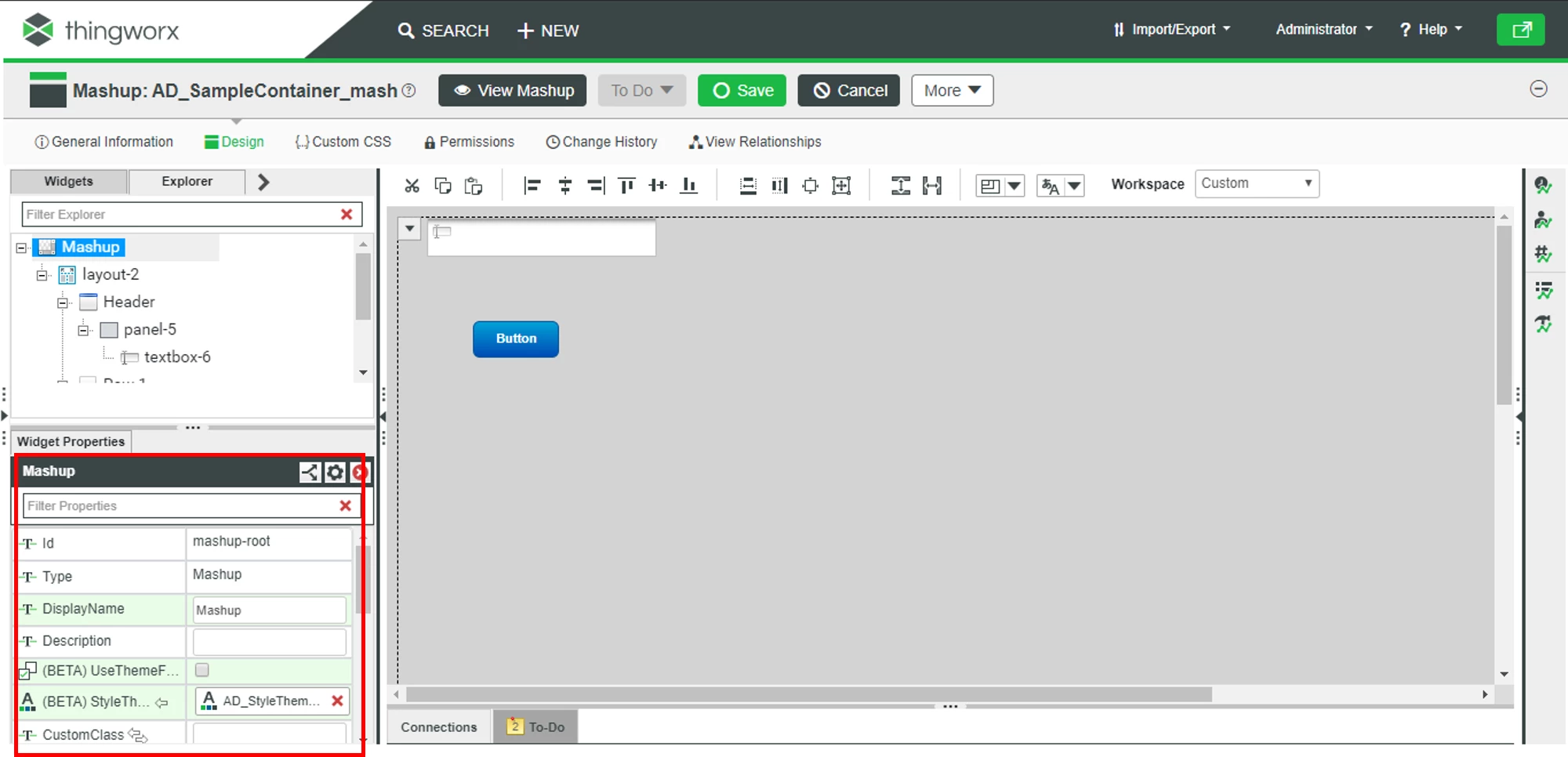

How to define a button as Primary or  Secondary through Style theme in a Mashup

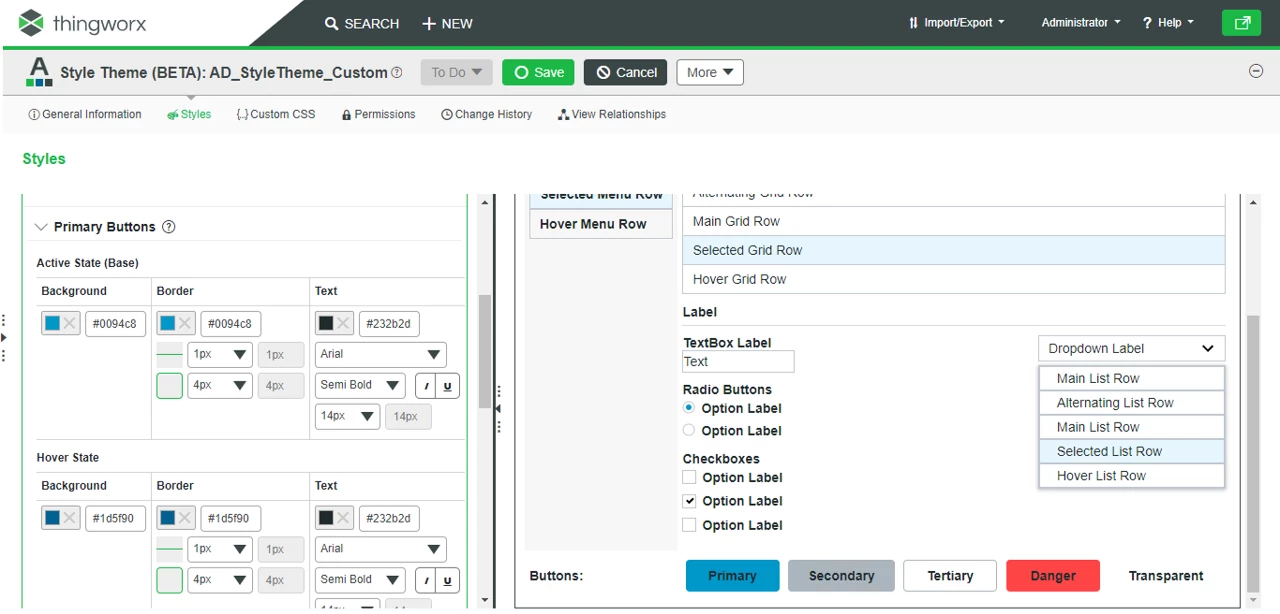

July 30, 2020
Hi @slangley ,
Here i have attached sample screen shot of creating the style theme and applying the style theme in the mashup but it is not working in the button widget
Support
November 6, 2020
Hi @mervinnobelraj.
It appears you're using the legacy button widget.  This one is not theme-able.
Try it with the new button widget and you should be able to set the Button Type.
Regards.
--Sharon
