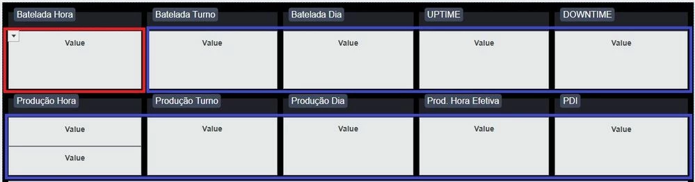

I have created one style theme to use in the value display widget in my dashboard and it is work well.
But I have created other style theme to use in other value display widget in other  mashup and when I binded that style theme on my value display all others changed too.
Is there any way to use one style theme to each value display?
Regards
Leonardo

I have thinked it too, but what happens is the follow:
In my image below when I change the style theme of one value display (for example: red) the all others (blue) change too
I would like to provide definitions for each one

are you using an 'embedded' approach so that each of these value displays are exactly the same?
i believe you can pass a custom class dynamically if you need to.
Also if you are using some overall class, you may need to remove that and only use the custom class definition.
Final thought, potentially your custom CSS if you are using an embedded mashup needs to be in that mashup vs the parent.
