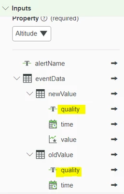

I would like to create a subscription for a remote thing. I would like to trigger this subscription when the property source quality (good, bad ) was changed. Could you please suggest a solution for resolving this issue?

You need to create a generic subscription to the DataChange event, and check inside if the old quality changed vs the new quality with a simple "if" , and based on the result, execute your code.

Create a subscription with DataChange event and under Event Data you have the new data and old data quality available as variables that could be added in the subscription code.
