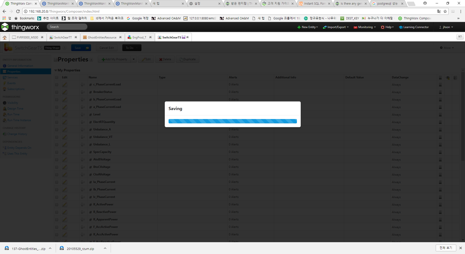

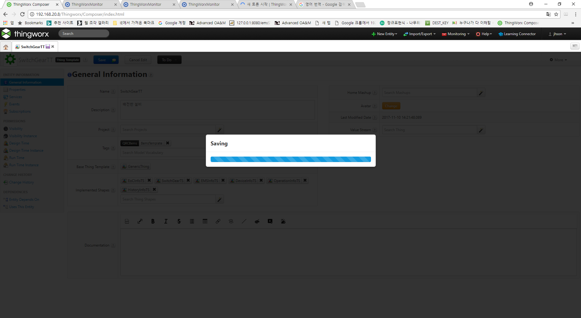

As if it were locked,It can not be saved. How should I find the problem

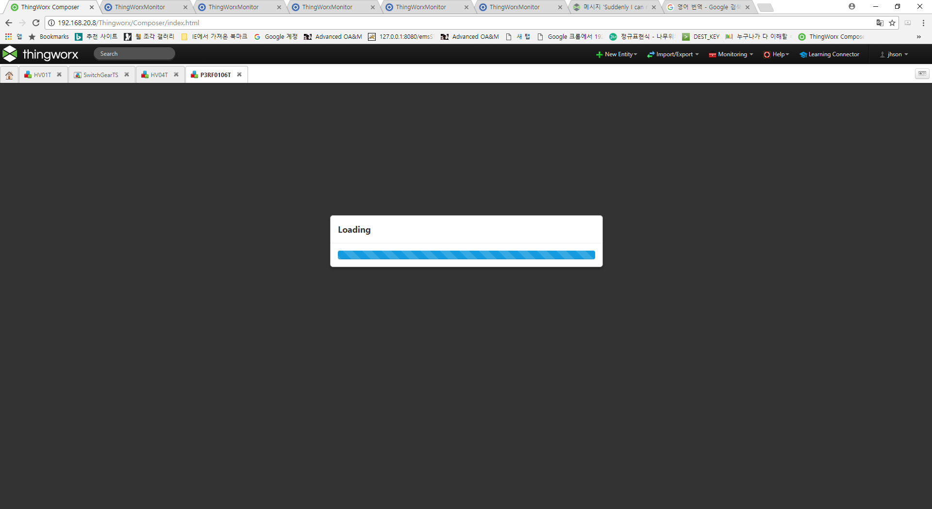

And I can not open a Thing corresponding to a ThingTemplate

    Hi Junghun, have you checked the log files from ThingWorxStorage/logs location? Is this only happening with one type of ThingTemplate? Which persistence provider are you using with ThingWorx?

    It seems to me that everything related to Thingtemplate is locked.

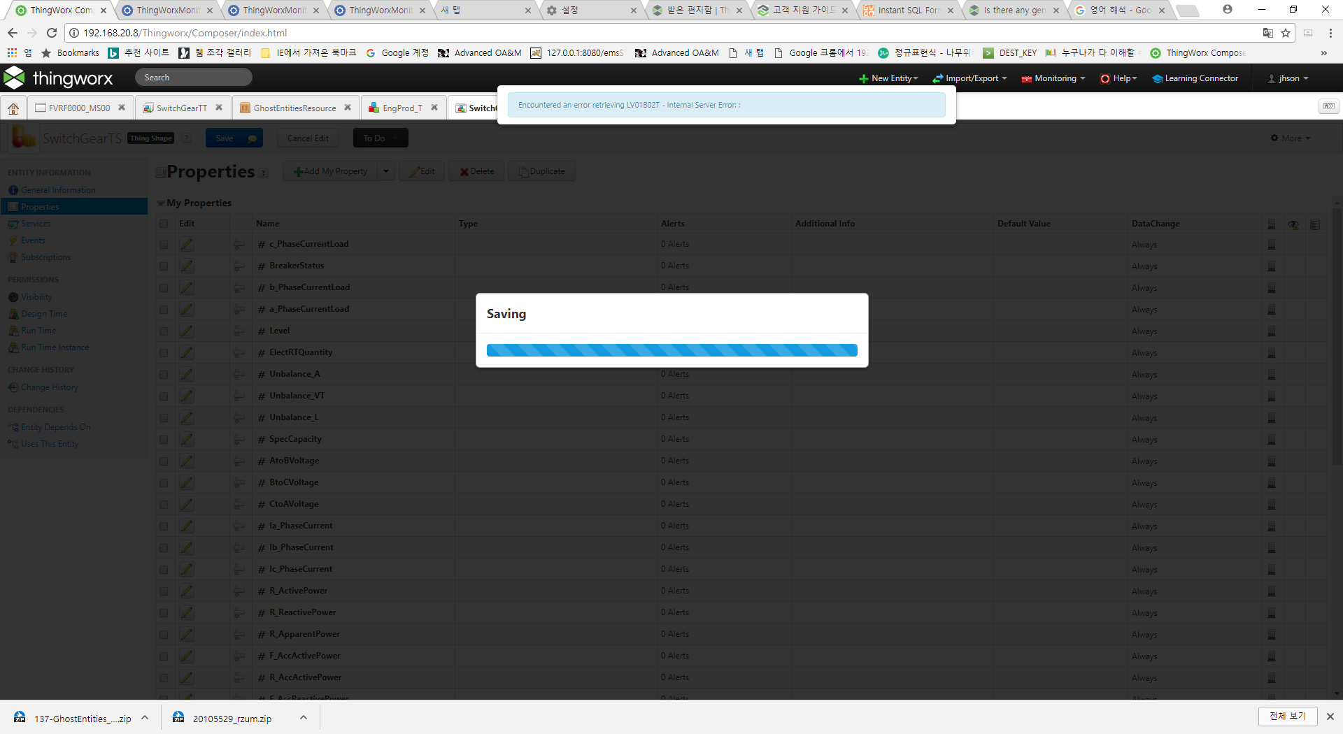

    Fixed ThingShape and it's been stopped
    Any Thing that inherits the ThingShape will get the following error. I can not find what the error is

    As far as I know the entity creation limit is applied in general not particularly to specific to ThingTemplates. You can check your license usage by navigating to the ThingWorx Composer > Monitoring > Subsystems > License Subsystems Settings
    These should be able to highlight if you have used all available quota of Things creation.
    Additionally, I would still encourage you to please have a look at the application log to get more specific error info.

    Concerning the saving issue, wondering if you have tried restarting the ThingWorx server?
