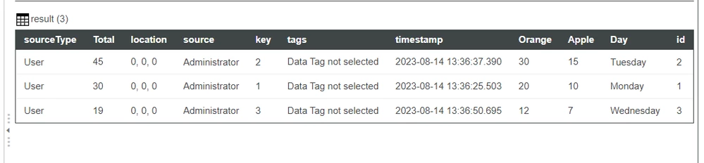

Aug 14, 2023 8:14 AM UTC
Hi @Janicen
Please try below code
// result: INFOTABLE dataShape: ""
let data = me.GetDataTableEntries({
	maxItems: 10 /* NUMBER {"defaultValue":500} */
// Add Total field to infotable to store total value
let newField = {
 baseType: 'INTEGER'
data.AddField(newField);
// Iterate over infotable data
for(var i = 0; i < data.length; i++)
 // Add Orange and Apple Count
 var total = data.rows[i].Orange + data.rows[i].Apple;
 // Update Total value to infotable
 data.rows[i].Total = total;
// Sort infotable based on highest total
let params = {
	sortColumn: "Total" /* STRING */,
	t: data /* INFOTABLE */,
	ascending: false /* BOOLEAN {"defaultValue":true} */
let result = Resources["InfoTableFunctions"].Sort(params);
// To get the highest sale day
// let result = data.Day // Output will be STRING and rename sort 'result' to 'data'
The output will look like this:
