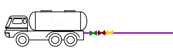

I would like to know how to display an SVG image with the functionality I desire. If I read a boolean value as 'on', I want to show only green color and hide other colors. If it's 'off', then display only red color and hide other colors. Is there a way to achieve this?
GabrielBAnswer
Apr 9, 2024 8:32 AM UTC
Yes, there is a way but it's not made extremely easy. The SVG is ultimately like an HTML to which you can apply styles.
There was a widget made way back for this exact reason, to make floor plans and have colored statuses all over.
https://github.com/ptc-iot-sharing/SvgViewerWidgetTWX
It should come with the necessary documentation in the README.
Hope this helps,
Gabriel
