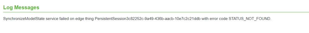

I am using GetProperties service from Dynamic ThingShpe, I have enabled automatic value update.
The properties which are being bind are set via service as it is calculated field (Not logged but persist). Thingworx version : 9.7
On page load I got warning in application log as below:
ApplicationLogApplicationLog
On Mashup log, below info shown:
MashupRuntimeLogMashupRuntimeLog
Any idea why I am getting this warning in application log, and how to avoid this.
smainenteAnswer
Oct 7, 2025 9:19 AM UTC
This is expected: the AlwaysOn JS client in Mashup does not yet implement the SynchronizeModelState service. The platform will fall back to the legacy service if this one fails.
https://www.ptc.com/en/support/article/CS423838

How ever I am not using remote properties, the value are being set by a service on a refresh logic.
And the source properties are being set via subscription as data coming from MQTT.
PTC says it can be ignored but any further insight in it to avoid the warning.
Oct 9, 2025 11:42 AM UTC
That service is invoked after every bind (irrespective if you have remote properties). I will report to R&D if it hasn't been done.
