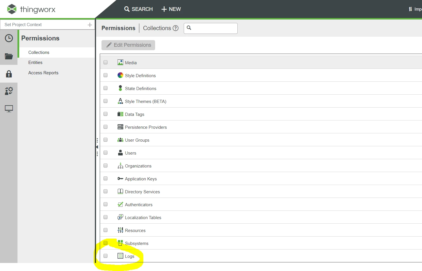

In the new composer Permission tab ->Collection permission ,there is Logs collection .You need to provide permission on this collection .Please see the attached screenshot to locate Logs in collection permission.

Hi @mnarang,
Do you know of any way to filter what log entries are visible to the non-administrative user? e.g. that they can only see the log entries as it is related to entities for which they have visibility permissions?

The log entries are being fetched using "QueryLogEntries" service of specific log types. There is already an OOTB filter on the Log page which has an option for selecting the user. The snippet of QueryLogEntries have many inputs to filter. If you want to filter using the OOTB log page then go for the filter options available .If you want to fix the filtering than you need to customize the log mashups to execute the service with required filter inputs .
