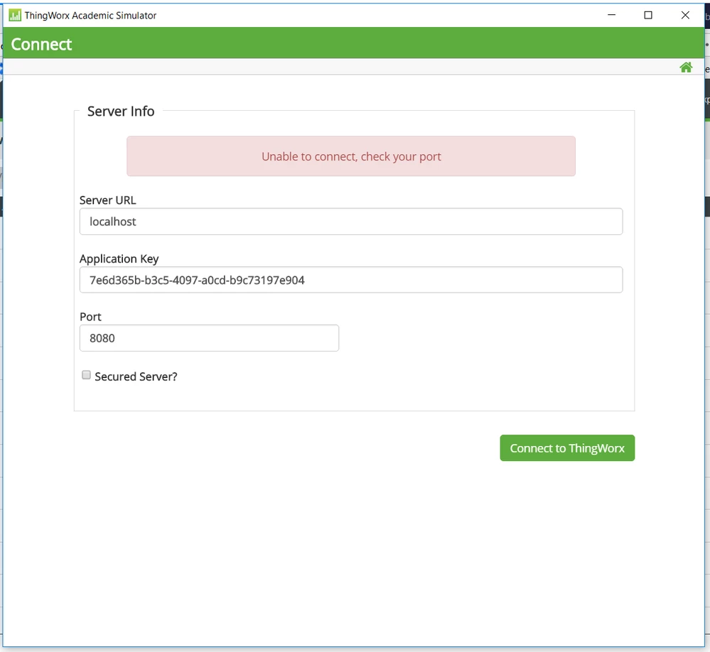

I'm using Thingworx with Tomcat, and I'm trying to connect Thingworx Academic Simulator but I encounter this error:
Thanks for help
Best answer by jaskulskij
I've added Group and Organization with my base user, gave them all permissions and now it works, so I guess this thread is solved

Hi @jaskulskij.
What is your ThingWorx url?
Regards.
--Sharon
October 4, 2019
I have http://localhost:8080/Thingworx, but to connect I was using "localhost".
Now my problem changed: when I use 127.0.0.1 instead of localhost it connects, Thingworx also sees a connection, but the list of Things in TAS doesn't load (it's empty). When I tried using PTC server it works just fine, but I'd rather keep using my local version.
October 4, 2019
I've just checked with Postman and it seems that I'm unable to Get any Thing from my Thingworx, maybe it's some kind of problem with permissions/location accessibility?
