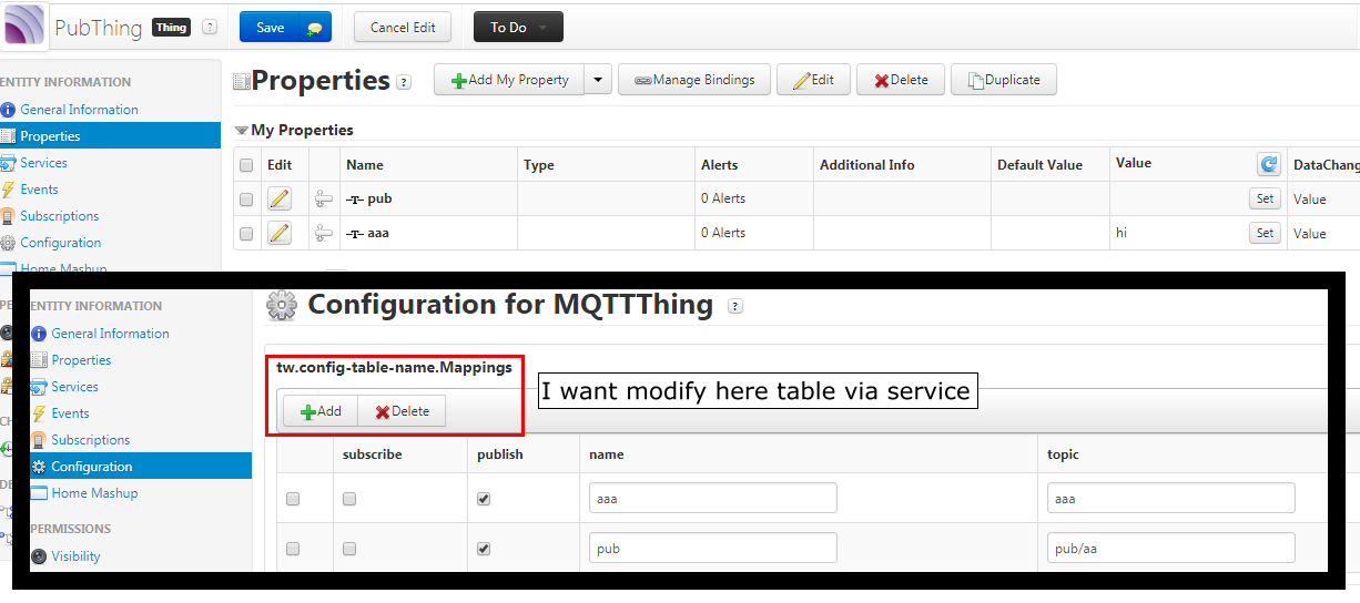

hi i'm SeonHo
I am preparing POC using MQTT extension.
I need to configure the Thing's Configuratoin to publish the data.
If i set the topic, Publish works well.
I want Topic to be automatically formatted like a Subscribe.
Or I want to add or modify configuratoin through the service.
Please reply.
thanks

Um ... You have not figured out the point of my question.
I am aware of the general usage of MQTT
So I receive the data value through communication now
The solution I'm looking for is to configure the configuration table of the MQTT extension through the service
Or like a subscription, the name and property value of the thing will automatically be used as a topic for publishing.
Thank you for answer
