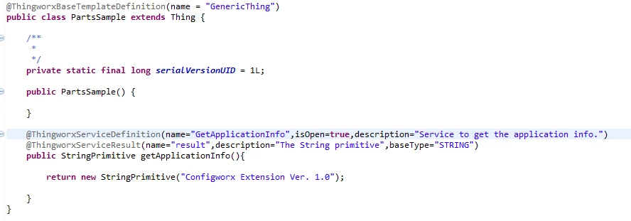

Hi. I'm currently trying to create a service using the java API, it creates fine, but when i go to the Composer and try to execute it the "Test" button is not visible.. Any idea about the cause of this? Thanks in advance.
Java code

Are you trying to run this service in a thing that have your thing template?
Just things can run services. To test you have to create a thing with this thing template. Did you do that?

Hi, VXavier, thank you for answering.. It was a silly mistake from me.. Indeed, i wasn't trying to run the service from a Thing
