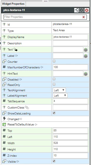

Text Area widget does not display
Text Area widget (BETA) does not display when the mashup is viewed.  I am on thingworx 8.4.5.  Did I miss something in the widget configuration?

Did you notice any errors in the console when you view the Mashup? What happens when you reload the Mashup page? Here is a thing you  can try:
  1. Navigate to Subsystems
  2. Find the PlatformSubsystem under it.
  3. Go to the configuration tab under the PlatfromSubsystem
  4. Check the option that says Enable Beta Mashup Features.
  5. Save the PlatforSubsystem and see if this helps.
Please try this out and see if you can view the Text Area widget now.
Willie16-PearlAuthor
December 17, 2019
I didn't notice any errors.  When I reload the mashup, nothing happens.  The area where the text area widget should be is blank.
I just enabled Beta Mashup option in the PlatformSubsystem, saved, and restarted the PlatformSubsystem, but I still don't see the text area widget.
