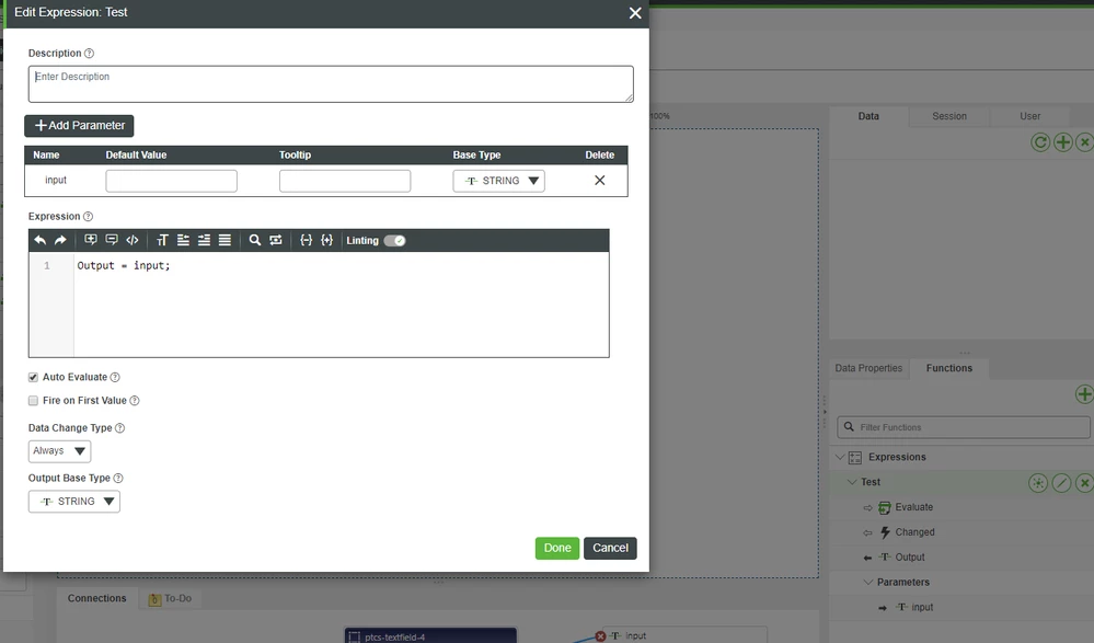

Hi Shalini V.,
You might be able to do this by using an Expression function (Expression widget in ThingWorx versions prior to 8.4).
Create an Expression that takes an input of your text string, set the output of the expression to be that string, and set the Expression to Auto Evaluate (Trigger the expression when any of its input values change) and the Data Change Type to Always. Then bind your input string to the Expression input you set and the Changed event to the services or mashup triggers you need.

Hi Shalini V.,
