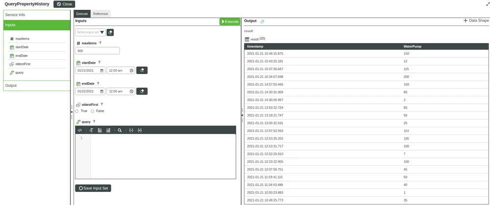

Jan 21, 2021 11:18 AM UTC
I have used QueryImplementingThingsWithNamedPropertyHistory so that I get the logged history data as well last updated value. But I m not getting the output when I used this into service. Can you suggest me what parameters are to be used to call this service.Or I should use some other service.
var result1 = ThingTemplates["Temp_DemoThingTemplate"].QueryImplementingThingsWithNamedPropertyHistory({
	propertyNames : {
 "rows": [{
 "name": "WaterPump",
 "description": "propertyDescription"
 "dataShape": {
 "fieldDefinitions": {
 "WaterPump": {
 "aspects": {},
 "description": "",
 "baseType": "STRING",
 "ordinal": 2
	nameMask: undefined /* STRING */,
	maxDataItems: 50000 /* NUMBER */,
	dataQuery: undefined /* QUERY */,
	startDate: StartDate /* DATETIME */,
 endDate: EndDate /* DATETIME */,
 oldestFirst: undefined /* BOOLEAN */,
	tags: undefined /* TAGS */
result = result1;

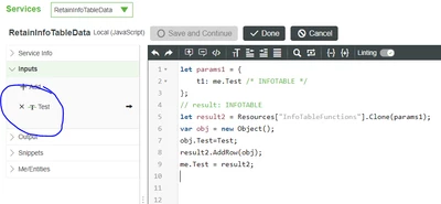

You can have a property of type infotable on a Thing. Make it persisted and then you can set it using below type of service where 'Test' is your input from text box. As you will add the value from text box all the values will be appended in the infotable property and if you want to get all the values you can simply do a getpropertyvalues on that thing property:
let params1 = {
t1: me.Test /* INFOTABLE */
// result: INFOTABLE
let result2 = Resources["InfoTableFunctions"].Clone(params1);
var obj = new Object();
obj.Test=Test;
result2.AddRow(obj);
me.Test = result2;
In above snippet my property name is Test and the input in the service is also Test ,so don't get confuse with many Test.
Mukul Narang
Jan 21, 2021 10:31 AM UTC
Thanks for the Reply.... but that's a lot of confusion with the 'Test'....
Jan 21, 2021 11:02 AM UTC
Let me paste some screenshot to make it more clear, one Test is the service input which will be binded to value of text box. Another Test is the property name (of type infotable) on the thing which will retain all the values for you.
