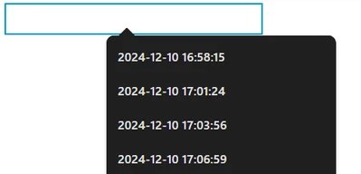

TextField Widget showing suggestion box upon clicking in ThingWorx 9.6.1
A suggestion box is appearing upon clicking in the middle of the text-field widget as shown below:
How to hide this suggestion box.

Hi @PG_CG
Can you try removing "Autofill form data" with "all time" time range option?

@wcui
The issue is still coming after performing the above step in chrome browser. But when I checked in Edge browser this is not coming.
So yes it is some browser cache issue.
