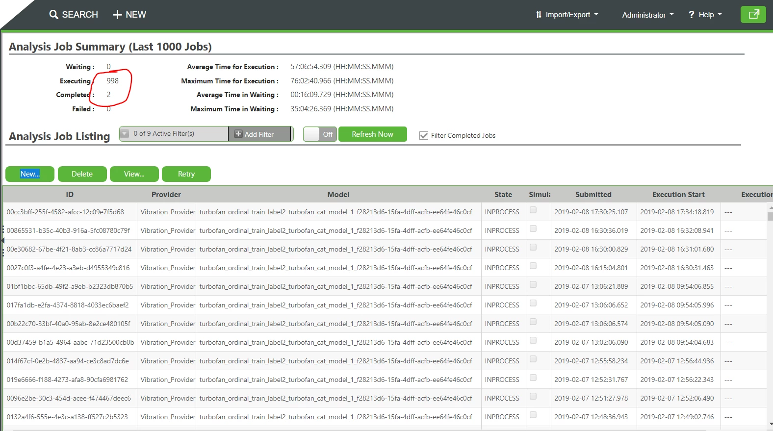

I have 997 in-process jobs in the "Analysis jobs",which cause machine very slow.  I thing the processor may overload for so many jobs , so I stopped the Analysis event and expect these jobs can be processed without generating new jobs .
I kept my machine running over night but found the number of executing jobs are NOT changed .

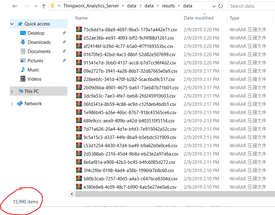

  • the number of csv files in C:\Program Files (x86)\ThingWorxAnalytics\Thingworx_Analytics_Server\data\data\results\data keep increasing.

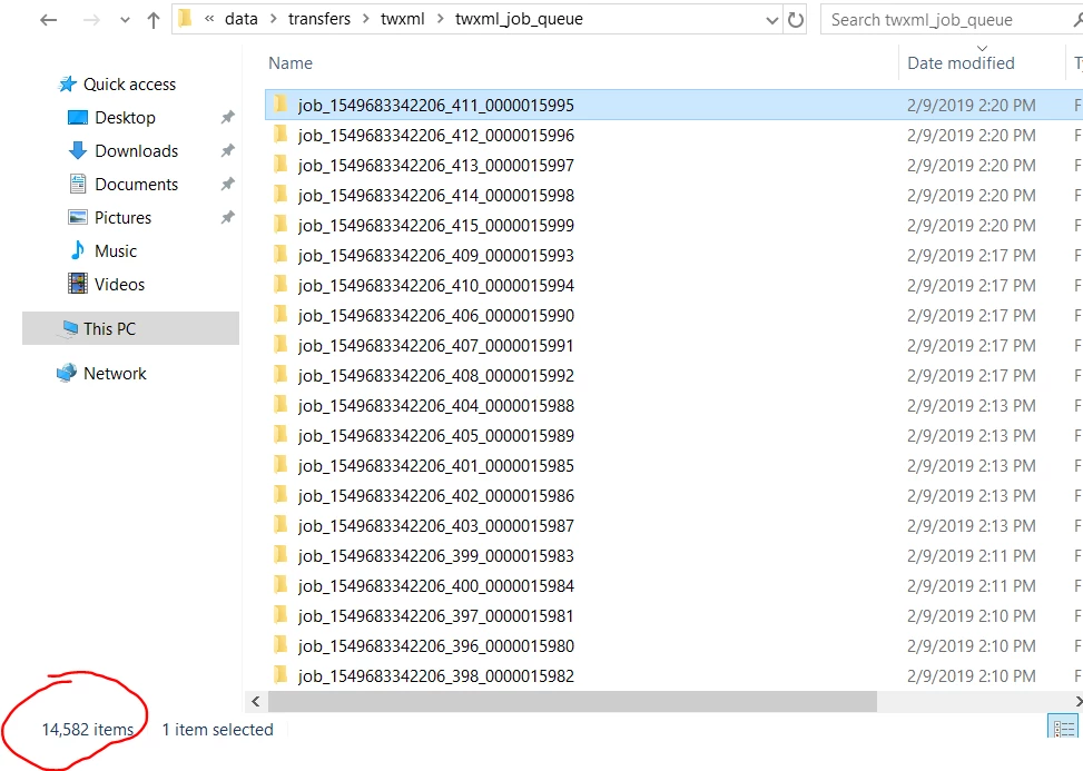

  • the number of job folders in C:\Program Files (x86)\ThingWorxAnalytics\Thingworx_Analytics_Server\data\transfers\twxml\twxml_job_queue keep increasing.
  • Open the file "DempsyClusterJobExecutor.Complete" for one of the job in the folder "twxml_job_queue", the content is  "["java.util.ArrayList",[["com.thingworx.analytics.ccc.job.Status",{"state":"COMPLETED","startDateTime":"2019-02-09T15:06:43.4Z","endDateTime":"2019-02-09T15:06:48.588Z","runTime":"0:00:05.188","queuedStartDateTime":"2019-02-09T15:06:26.312Z","queuedDuration":"0:00:17.088"}]]]" .  So it seems that the new jobs are still being generated as I disable the analysis job on 2019-02-08 ?.

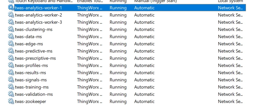

  • 4. twas-analytics-workers running well
