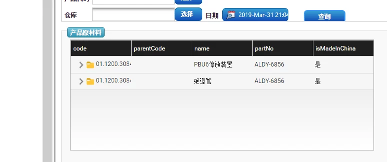

The header of the tree grid doesn't display correctly after the page get loaded .  Only after triggering data binding ,for example, by click a certain , then the header can display well .

The problem is the header , not the data inside the tree grid.  I bind the DataShape to the tree grid , the header display correctly in the design time , but doesn't display in runtime untill the service get the data.

It's a bit confusing ,generally we bind infotable data (coming from a service) to the grid which holds header and data both .And in design as well as in run time it display both without any issue .But as you said you mapped a data shape to the grid which displayed header in design time and then in run time it does not display until the data come from service .How exactly you have mapped the infotable data to the grid ?
