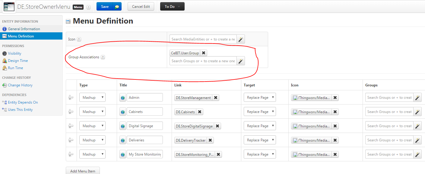

    Apr 4, 2016 10:19 PM UTC
    Hi, Maybe it's too late, but may someone come here later from google like I came.
    I had the same issue, the solution was adding my user group to menu "Group Associations" , inside "Menu Definition"

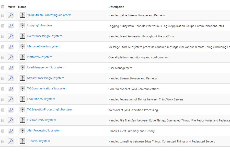

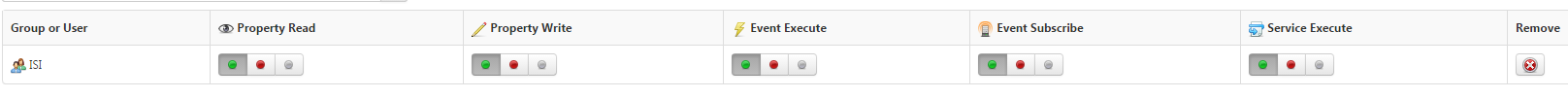

    Oct 20, 2015 8:38 AM UTC
    Hi
    You need to give your User(s) visibility and runtime permissions for the PlatformSubsystem.
    Regards
    Ian
    Oct 19, 2015 10:07 PM UTC
    Did you give that account permission in the Subsystems area?  Your objects will not render properly and this could be causing your issue. It is located in the left menu on the Home Page, under System.
    kqian1-VisitorAuthor
    Oct 20, 2015 12:39 AM UTC
    I have found the Subsystems area,but which item should I give the account permission?
    Oct 20, 2015 5:28 PM UTC
    PlatformSubsystem
    May 10, 2016 8:13 AM UTC
    Thanks this works
    But i dont know if i also had to do all these steps before. So maybe all of them are necessary or just some of them.
