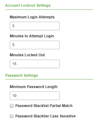

The length can be changed in UserManagement Subsystem

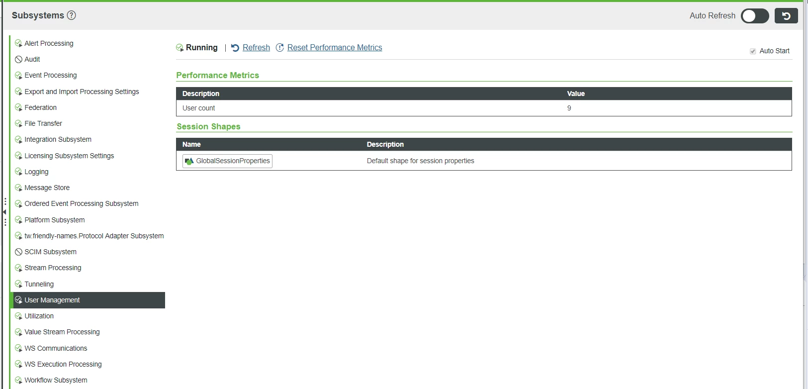

@zyuan1 ,
I checked the UserManagement subsystem, but didn't find where I can change the password length.  The screenshot is attached.
July 9, 2019
Please go to System - Subsystem - User Management - Configuration, the page you opened is Monitor - Subsystem
