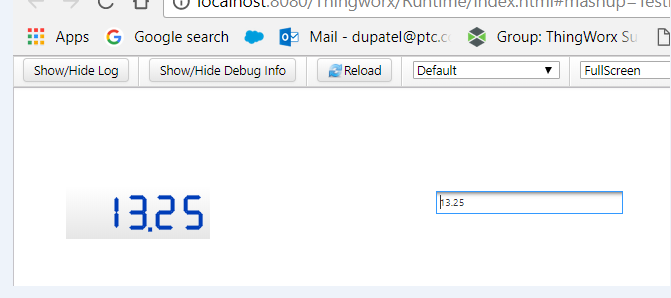

Dec 18, 2017 11:20 AM UTC
Alejandro Mejia​ I checked this on my local TWX 8.0 version and seems to be appearing fine. PFA
There could be some issue with your particular widget properties. So, please share property details to review further.

amejia112-AmethystAuthorAnswer
Feb 6, 2018 12:35 PM UTC
The problem was only present when the language of the current user was in french. It was only necessary to change the comma by a dot for the "decimal" token in the french localization table.See screenshot attached here.ScreenshotLocalizationTableToken.PNG
