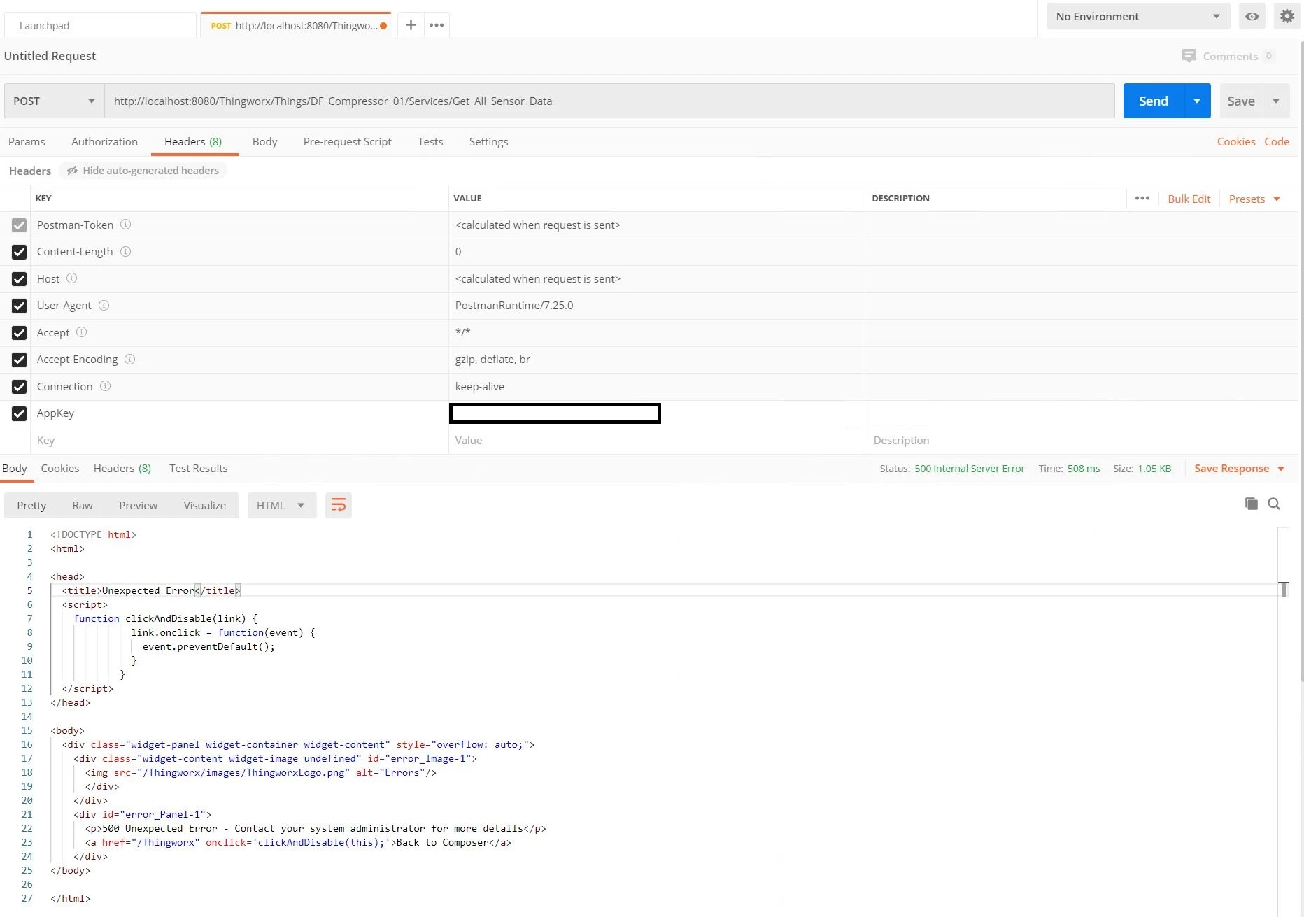

we would like to call a Service, which returns a JSON, when you call it with a POST request.
Unfortunately, we get the following response when we call the Service via Postman:
The URI we use: http://localhost:8080/Thingworx/Things/{ThingName}/Services/Get_All_Sensor_Data
The Response:

Our current code:  (not final)
var result = {};
if(code >= 500)
try
result.message = Resources["JSONErrorResource"].GetBadRequest(
{content: {"plop": "error"}});
result.status = "200";
catch( err )
logger.error( "The following error occured. " + err );
result.status = "500";
result.message = "Some Error message here";
else
result.message = "ok";

HI @DigitalFactory.
There are a lot of questions here:
  • What happens when you run the service directly in Composer?
  • What account (appKey) does the service run under when calling the Post request?
  • Can you provide a screenshot of your Post request in Postman with the headers so we have a better idea of what you're sending?
Regards.
--Sharon
Jun 19, 2020 6:51 AM UTC
HI @slangley,
thanks a lot for your answer.
Please find the requested information below:
When we execute the code in composer we get the following error message:
"Error executing service Get_All_Sensor_Data. Message :: ReferenceError: "code" is not defined. - See Script Error Log for more details."
The appKey is bount to the Administrator. I know that is not best practice and just used for test purposes.
Please find a screenshot of our post man request attached.
