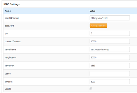

I used MQTT  extention in Thingworx (I have impoted the MQTT estention) and I created a Thing using  Thing Template MQTT.
I have configured the connection Mqtt to Broker mosquitto using serverName test.mosquitto.org

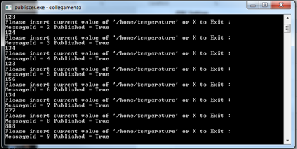

I have  developed a Mqtt published publisher.exe using  C#.
I checked the system and Thingworx has received the values published from publisher.exe.

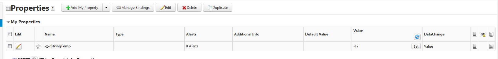

The property value on Thingworx was defined  as STRING with persistent and logged enabled.

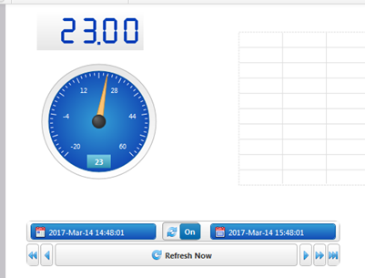

The property values  published from publisher.exe are visible on Thing property (by refresh) or in mashup that used GetData service (GetProperty + convert string value to number) that refresh the value every every 5 second.
When I want to look the property value using a widget  Time Series  Chart by QueryPropertyHistory I’m not found value in value stream.
The property value was received from the MQTT broker but they  are not stored in value stream, Why ?

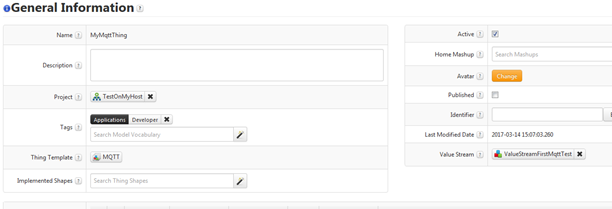

Hi Dimitri! Have you checked the properties as "Logged"? It is required to push them to the Value Stream.
March 14, 2017
Hi Adam,
many thanks for your answer.
The Property of thing  have persistent and logged enabled.
BR

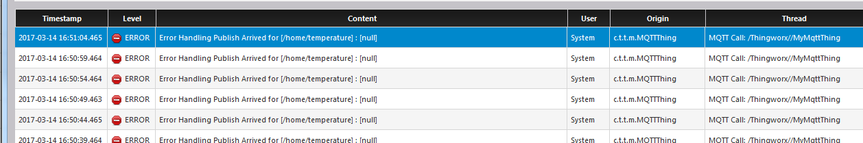

I checked the Application Monitoring and I received the following message (I think for any value received from Broker).
These message could be the reason that the value stream was not loaded ?

did you find solution? I do not want parsing data. I have values from device in property view, but they can not store in Value stream. If I try make subscription on anydatachange for move values to other properties then I get also error in application log. Can anyone help me please?
TWX 8.1, local installed MosquitoBroker on 1883 and MqTT extensions 2.1.0
Error Handling Publish Arrived for [DemoThing/DoorStatus] : [null]
