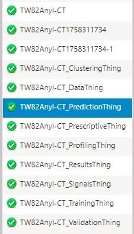

Just out of curiosity, when I look at the connected remote things there is a PredictionThing connected by default as in the screenshot:

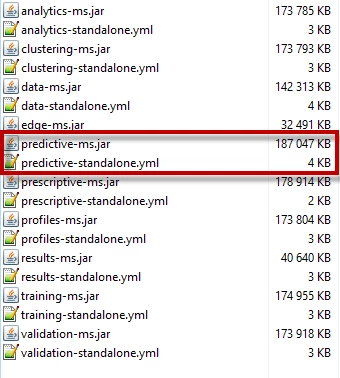

And in the default standalone_jars file on the analytics server, you already have the predictive-standalone.yml file as well as a jar file called predictive-ms.jar.
 What is the role of the default "PredictionThing" that is running and the "predictive-ms.jar" file?

Apr 9, 2018 1:53 PM UTC
Hi
The PredictionThing that you see is one of the service things created by ThingWorx Analytics Server.
ThingPredictor is an independent standalone scoring service.
It actually does use a similar engine but is packaged in a standalone way to allow  access to the scoring functionality without the need of a full ThingWorx Analytics Server.
Note that this is true as of release 8.2. It is likely to change in future release where we probably will have only one scoring agent.
Hope this answer your question
