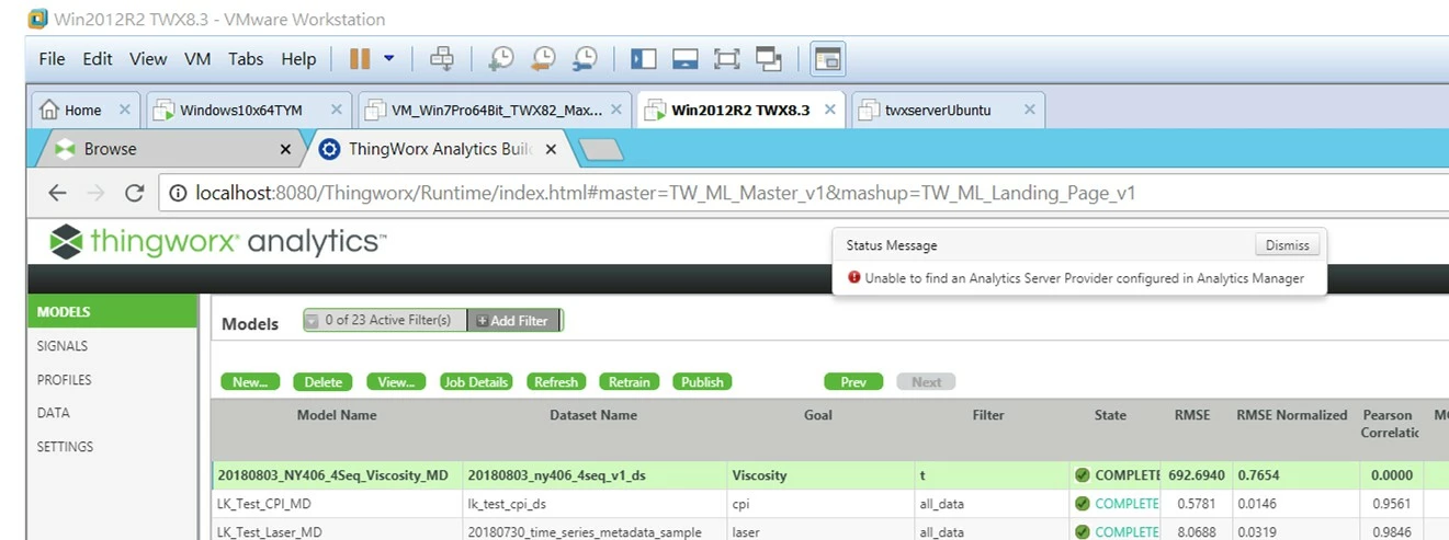

Hi
I want to use Analytics Manager in ThingWorx 8.3 version.
I try to publish a Model in Analytics Builder, but didn't work.
Then message show "Unable to find an Analytics Server Provider configured in Analytics Manager"
Could you please help this issue?

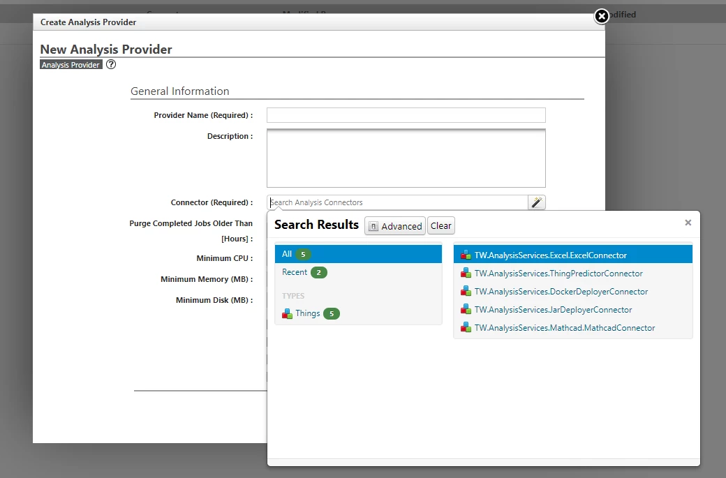

Sep 25, 2018 1:26 PM UTC
Hi Neel
I created two new servers with the latest version of the platform (8.3.2) as well as analytics (8.3.1) and it is now available.
Johan

Aug 27, 2018 3:32 PM UTC
Thank you for posting to the PTC Community.
Have you reviewed the deployment guide and HelpCenter instructions for ThingPredictor?
You can find the HelpCenter - How ThingPredictor Works here
Also, you have the option of using the TW.AnalysisServices.AnalyticsServer.AnalyticsServerConnector native to Analytics Manager, instead of using the Standalone MicroServices.
Documentation around how to accomplish this can be found here.
Neel
Sep 18, 2018 7:29 AM UTC
I don't have the "TW.AnalysisServices.AnalyticsServer.AnalyticsServerConnector" as an available provider.  I have installed the 8.3.0 as well as the 8.3.1 Analytics Extensions and it is still not available.
Sep 25, 2018 1:20 PM UTC
Did you download the installation sources from support.ptc.com? If so, when did you download the extensions?
What operating system are you using for your deployment?
