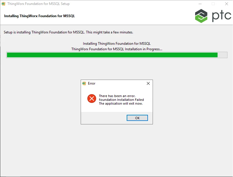

Hi guys,
I try to install thingworx foundation, but close to ending process appears error popup " there has been an error. fundation instalation Failed the application wil exit now"
Windows Server 2019
Fundation vr: 9.3.8
Java :11.0.12
Remote
MSSQL 19.02
JibacacheAnswer

Apr 24, 2023 3:13 PM UTC
Hi  @Velkumar
the problem it's solved, we have error in %Java_Home%, once corrected it worked perfectly
thanks a lot

Apr 22, 2023 2:34 PM UTC
Hi @Jibacache
Please refer to this article to find the installer error log
Refer to this article once you find an exact error message
If there is some other issue please upload Installer.log to check further
