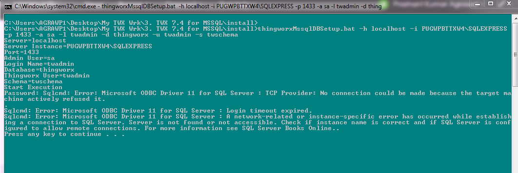

When executing the 'thingworxMssqlDBSetup.bat' file i get an error stating
"Sqlcmd: Error: Microsoft ODBC Driver 11 for SQL Server: TCP Provider: No connection could be made because the target machine actively refused it"
Here are the parameters i am using, the database is on the same machine so localhost should be correct.
server=localhost
serverinstance=SQLEXPRESS
port=1433
adminusername=sa
loginname=twadmin
database=thingworx
thingworxusername=%loginname%
schema=twschema
I have also checked that remote connections are enabled and that TCP/IP is also enabled for the SQL service. Anyone else had this issue?

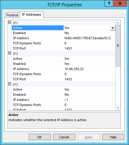

Found the solution.
In the Configuration Manager -> SQL Server Network Configuration -> Protocols for *instancename* -> TCP/IP Properties -> Ip Addresses.
On all the available IPs i had to define the port was 1433 as seen below, after that, no problem!

May 24, 2017
Hi Guys,
I am facing same problem and I am not getting any luck with the proposed solutions.
This is what I am getting:
I have entered that 1433 port in every IP as well.
But still I am getting this problem!!!!!!
Please help me.......Thanks
July 21, 2017
     If you did restart the SQL service after you did the changes that Matthew suggested and it still doesn't work, just change the status of the TCP/IP protocol from the SQL Server Configuration Manager from Disabled to Enabled, restart the service again and try. For me it worked like that
