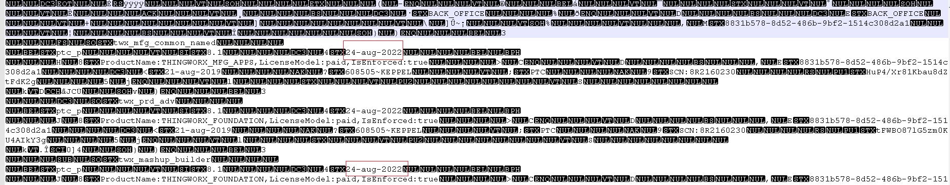

Hi, tried to renew the license in thingworx platform 8.3 , but the platform kept ignoring the new license.
1. had renew other instances in different servers, all working fine.
2. tried to generate two times license file, all failed.
3. device ID from licenseRequestFile.txt
Any suggestion ?
Error messages:
2019-11-25 15:14:48.575+0800 [L: ERROR] [O: c.t.s.s.l.LicenseFetcher] [I: ] [U: SuperUser] [S: ] [T: localhost-startStop-1] Unable to process capability response because Response does not match system hostid.
2019-11-25 15:14:48.580+0800 [L: INFO] [O: c.t.s.s.l.LicensingSubsystem] [I: ] [U: SuperUser] [S: ] [T: localhost-startStop-1] Unable to read trial license file. Attempting to load as Paid license
2019-11-25 15:14:48.644+0800 [L: ERROR] [O: c.t.s.s.l.PaidLicenseManager] [I: ] [U: SuperUser] [S: ] [T: localhost-startStop-1] Current license is past expiration date. Shutting down the platform!
2019-11-25 15:14:48.644+0800 [L: ERROR] [O: c.t.s.s.l.LicensingSubsystem] [I: ] [U: SuperUser] [S: ] [T: localhost-startStop-1] ====================================================================
2019-11-25 15:14:48.644+0800 [L: ERROR] [O: c.t.s.s.l.LicensingSubsystem] [I: ] [U: SuperUser] [S: ] [T: localhost-startStop-1] Current license is past expiration date. Shutting down the platform!
2019-11-25 15:14:48.645+0800 [L: WARN] [O: c.t.s.ThingWorxServer] [I: ] [U: SuperUser] [S: ] [T: localhost-startStop-1] Shutting down the Platform.

It clearly states that the new license you applied expired, you could upload your license file here and we'll check it for you.
hkumar-411-VisitorAuthor
November 26, 2019
thanks for reply.
the license just generated from the license system.
the portal not allowed to upload license file, kindly looked at the attached picture
November 26, 2019
It's common that the license file has 2 deadlines inside, especially if there's MFG or Navigate support in the package. What's the datetime memtioned after Name=twx_named_user ?
