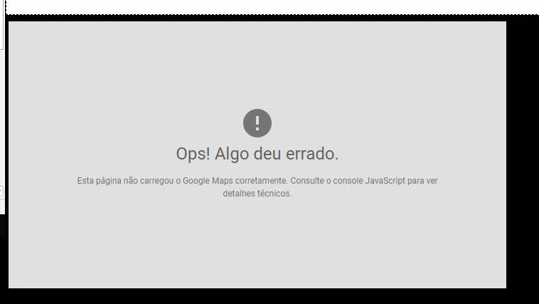

I am having difficult for show the google maps in my mashup.
Happen the following error: "Oops! Something went wrong. This page didn't load Google Maps correctly. See the JavaScript console for technical details."

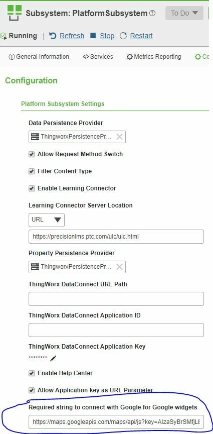

You need to enter a full URL, not just your API key. If your API key is: ABC123ume, you would need to enter
https://maps.googleapis.com/maps/api/js?key=ABC123ume
There are step-by-step instructions here:
https://developer.thingworx.com/en/resources/guides/google-map-widget-how/configure-google-maps-widget-extension

I followed the guide that you have sent me (https://developer.thingworx.com/en/resources/guides/google-map-widget-how/configure-google-maps-widget-extension) but the problem to be continued.
Below my configuration:
In my mashup the Google Maps get the same wrong:

Alternatively, you may try using a Webframe widget in the mash up and set the URL of the widget to the google maps with your embedded api key. For example 'https://www.google.com/maps/embed/v1/place?key={your api key}&q=40.05706,-75.670788'. Please refer Google maps API documentation as you may render different kinds of maps such as a Route, location search etc based on the URL you pass.
