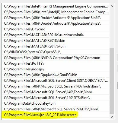

photo_environ_scan.JPGYes, you are right. It was upgrade yesterday but I didn't make the link between the two event due to the delay.
I add the path like you said but I still have the error did I miss something. I add the path on the environnement system. Path highlight on the capture.
Thanks for your help

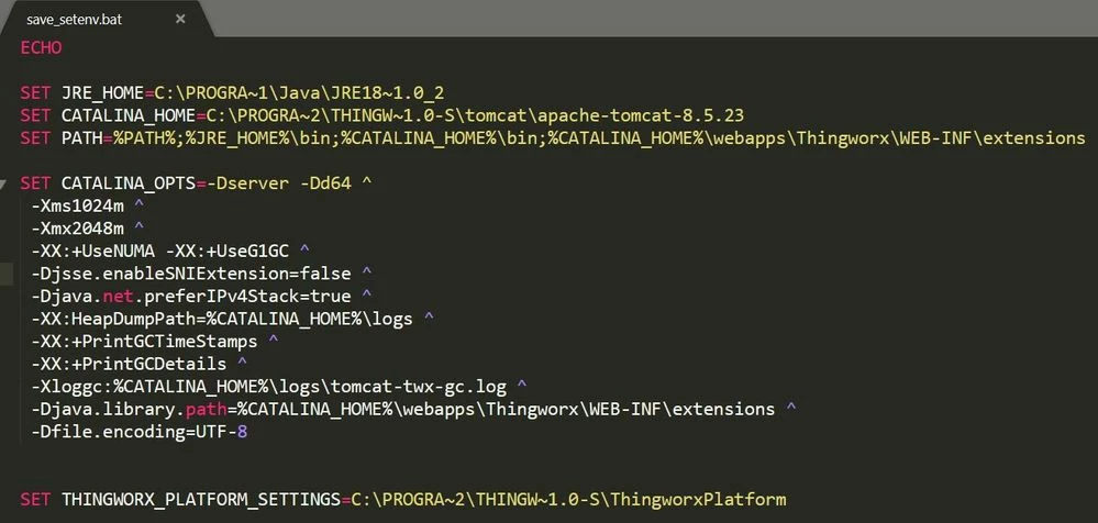

I made some research and I found that on the setenv.bat the path are write.
So I check if something was wrong but it seems okay, the jre_home is link to my latest java version.
Does someone know why there are ~ are the path name ? Is this some kind of abreviation ?
Is there an another files that I should check for tomcat ?
I used to have two tomcat but i uninstalled the second which wasn't link to thingwork and was more recent.
