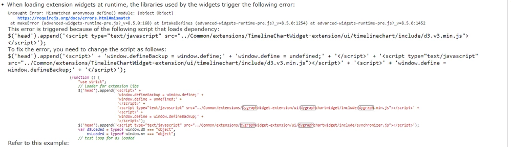

Hi, we got the errors in runtime after import custom widgets, which have documented in release notes in thingworx 8.5, as below:
we have modified the code accordingly, however it didn't work.
Anyone have clear idea how to solve this error, which file should we paste the code as different widgets have different file structure.
Thanks.

Hi @hkumar-41.
Please provide your code from before the change and after so we can validate.
Regards.

Hi Sharon,
We were using the advance chart downloaded from PTC market place. I believe you can download. if cannot, let me know, i will upload here.
