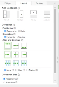

previously in 8.3 i have used a frame layout widget but after migrating to 8.5 the only one frame is visible in runtime.

There are changes in how layout is handled. Have you looked at the Layout tab?
With the layout tab you can create additional containers. You can set the positioning on the items in the container.
