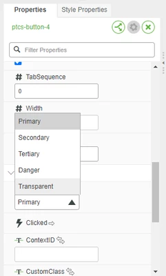

Hi Team,
I am trying to use Style Themes to set style to my button. There are multiple button styles defined in my style theme like for primary button, secondary button, Transparent button. How can I use a specific style like secondary button style to my button ?

You should be able to change that right in the button properties:
Is that what you're looking for?

@Bhanu_Manoj ,

Yes, This is what Iwas looking for.
Thanks a lot.
