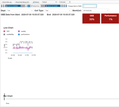

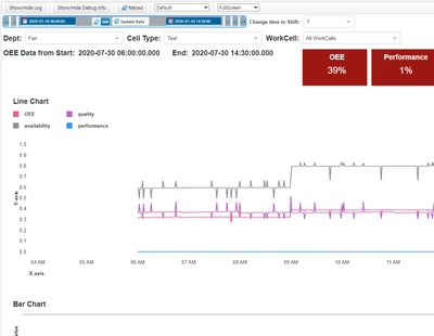

After upgrading to thingworx 9.0, I created a mashup with some of the new widgets, specifically the line and bar chart. Everything is looking good until I added that mashup into a master. Then the chart widgets became scrunched and stretched (See attached screenshots) I then tried with a new, from scratch master and mashup. Same result. Any help on this would be greatly appreciated.

After digging into this for way too long, I think there's something about the .widget-ptcschartline CSS properties. When the line chart is in a master the position property is set to relative, but when it's not in a master it's set to absolute.
I found that if I put this code in my mashup's Custom CSS code, that seems to do the trick.
.widget-ptcschartline{
position: absolute !important;
This still seems like a bug with chart widgets. I don't know enough about CSS to know if this is a fix or a band-aid. I would still appreciate if anyone has any ideas about fixing this long term. Thanks,
