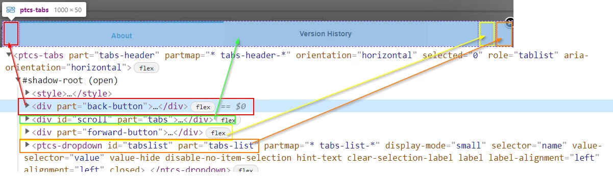

I am working with ptsctabset witdget on TWX 9.0. I would like to have tabs on the bottom spreaded to whole widget width. For that I need use custom CSS to disable not needed parts - back-button, forward-button and ptcs-dropdown part.
Unfortunatelly, I am struggling to use correct selectors. Could anyone please help me with it?

thanks for that article. It helped a lot. However, for that particular part of ptsctabset widget, I am still unable to "reach" it via any CSS selector. Could you please try to suggest how can I set styles for that particular parts - back-button, forward-button and ptcs-dropdown?
Thank you very much in advance.

I do not know the entire answer to your question. The following will reduce the size of the back and forward buttons.
.widget-ptcstabset:host::part(tabs-header)::part(back-button) {
    padding: 0;
.widget-ptcstabset:host::part(tabs-header)::part(forward-button) {
    padding: 0;
