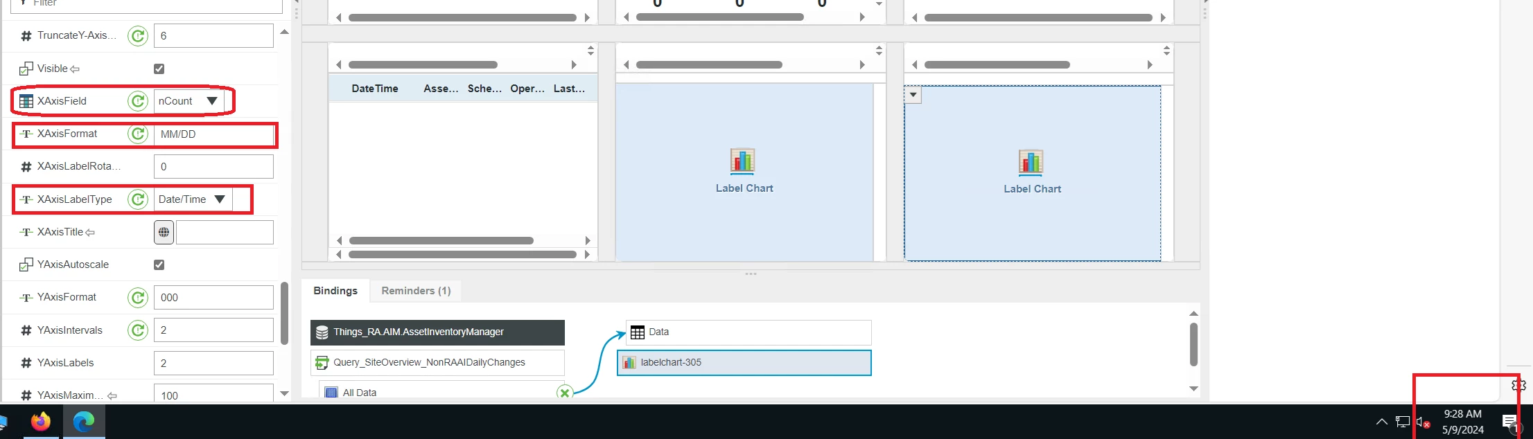

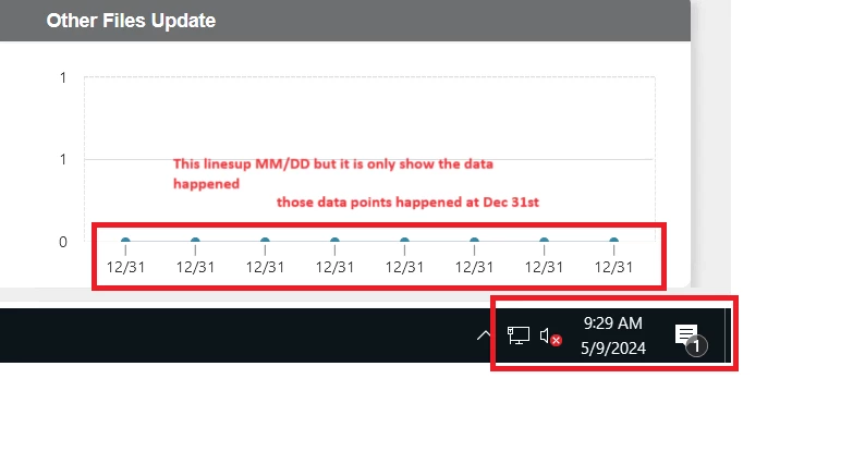

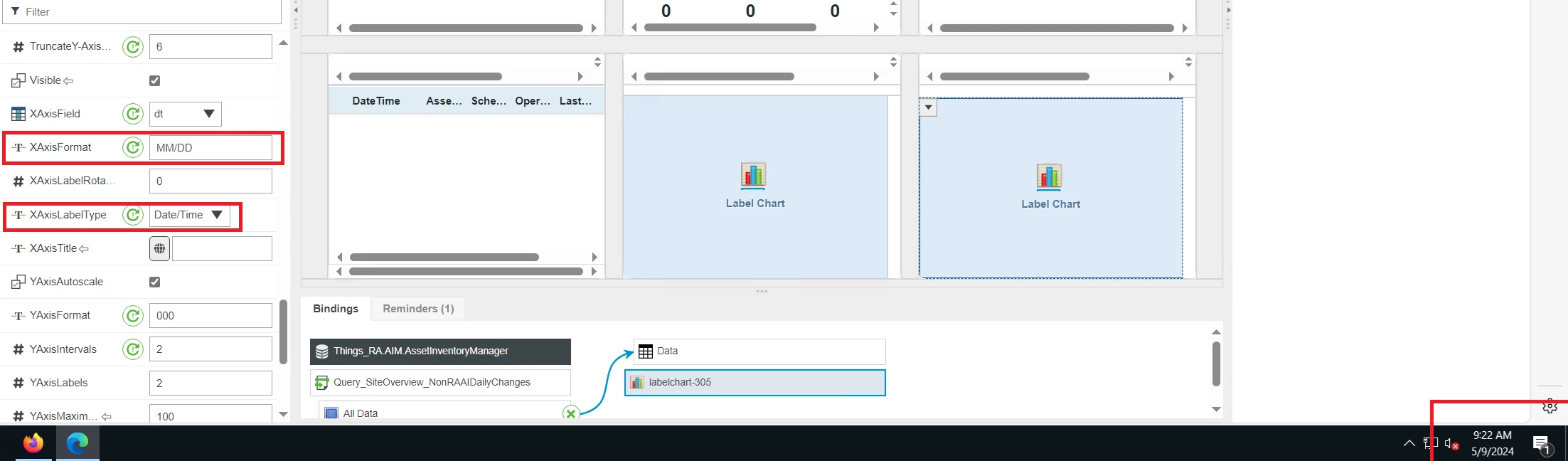

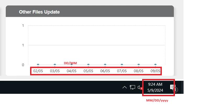

Hello, I am pretty new for Thingworx, I am using the Labelchart widget and would like to change the XAxis marker format from DD/MM to MM/DD to line up my host server setup, now my system shows MM/DD/YYY but my Labelchart X Axis shows DD/MM, the setting for the Labelchart is as follow:
XAxisLabelType: DateTime, XAxisFormat is MM/DD and XAixsField is dt, this setting is always shows DD/MM on my XAxis, only when I changed the XAxisField to nCount, I will get the MM/DD but the XAxis is not line up with current time. Seems the Labelchart cannot be localized

@Surya_Tiwari Thanks for getting back, I actually figured out it is the application locked down the dt with using query, indeed if I don't choose dt but just nCourt, the MM/DD works.

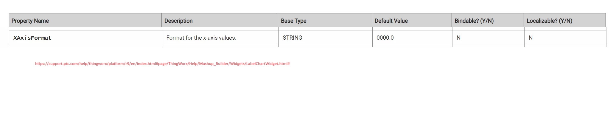

Hi @RL_9400154   Look at the below reference article.
https://www.ptc.com/en/support/article/CS341400
