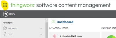

I am trying to configure SCM for ThingWorx 9.5 and have imported the SCM extension. I have also given permissions to my user as mentioned in this url.

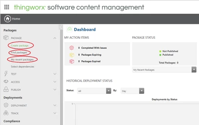

However I am finding that none of the navigation links given below are working. I have tried to debug the issue but nothing is turning up over there too. I have tried opening the SCM page in both Chrome and Edge.

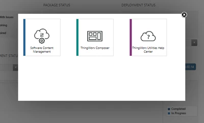

1) Click the Menu button in top lef corner. It will open the popup with quick menus.
2) Then click the "Software Content Management" Tile
I hope it will helps you.
