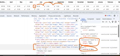

In TWX 9.6 the edit icon or link have padding and are too big. I can change this very easily in the console as shown below, but I cannot figure out how to do this in the CSS, or if there is another way. I am trying to do this...

Hi @JO_9930585,
Try the following custom CSS:
Type Icon:
@supports (ptcs-style-unit: "PTCS-CORE-GRID") {
 [part ~= edit-control] {
 width: 12px !important;
 height: 12px !important;
 padding: 0 !important;
Type Link:
 font-size: xxpx !important;

This article is for the old grid widget from 9.0 to 9.5. I am in 9.6 using the new widget.

Hi @JO_9930585,
Type Icon:
Type Link:
