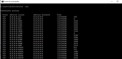

Yesterday I was working on my projects using my personal laptop because I have the free version of 3 months. and then I had some problems of "rest api failure". I didn't found any file in my (Things, datashape,thingshapes....) so I decided to restart my computer and after thingworx started to work again normally.
Today I tried to connect but I have this page and I really don't know what is the problem, the only thing I get is this page.
Could any one help me please ? I had all my projects on it and it's verry disturbing.

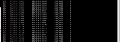

I'm using 8080 port and yes it may be a problem of tomcat also. I restarted my laptop yesterday and now Thingworx is working again hopefully. In my opinion the problem occured because my port has been occupied by another application because ports rests after a reboot in general. but I'm not sure a 100%.

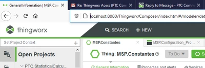

The URL in the screenshot corresponds to the mashup builder page for the mashup named PTC.SPC.Monitoring_MU. What happens if you navigate to just localhost:8080/Thingworx?
Do you see any error in the ApplicationLog.log file in ThingworxStorage\logs folder?

when try to reach the Thingworx home I get This, and when I try to reach only localhost:8080 I get error 404 page not found. I don't have acess to thingworx log application because I can not acess to thingworx
Do you think that I have a problem maybe with the configuration of my port ? Thank you verry much for your answer
Sep 8, 2020 7:36 AM UTC
Getting a 404 in localhost means Tomcat not working, are you using 8080 or 80 port?
And you can check in Tomcat Catalina log why it's not working.
