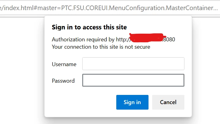

Hello All,
How redirect Thingworx AMU application to form login page after logout?
Is there any OOTB solution for this?
I tried debugging the Mashup (PTC.FSU.COREUI.MenuConfiguration.Header_HD) and found out that there is no mashup given in logout function, so it is trying to redirect to index page and login popup comes from top(refer screenshot).

Hi Javed
It's not just an AMU logout, it's an entire Thingworx logout. So even if you tried to redirect to another Mashup, you would get the same login popup. An example of this is : if you log out of AMU, you also get logged out of Composer.
Currently the Logout button just redirects to the main Thingworx Apps (AMU & others) menu. I believe this is because of the Mashup name given in the parameter in the URL, but I'm not familiar enough with this to confirm if/how this could be changed inside a Logout button. Normally the main Mashup can be found at http://SERVER_NAME_HERE:8080/Thingworx/Runtime/index.html?mashup=PTC.FSU.COREUI.MenuConfiguration.MasterContainer_EP, but I think if you just write another Mashup name in this URL then you will see that Mashup.

Now, about the Logout (and mostly, Login) behaviour : it's Organization-based. Users in Composers are separated in what we call Organization. By default, all users are part of the Everyone Organization, but you can define smaller ones. In the Organization's settings, there are multiple settings such as login prompt, image, etc. You can modify these to change what it looks like when this specific Organization's login window is reached. For more information on this, see https://support.ptc.com/help/thingworx/platform/r9.6/en/index.html#page/ThingWorx/Help/Composer/Security/Organizations/CreatingLoginPageFormsforOrganizations.html. While you're there, change the Organization's Home Mashup setting to http://SERVER_NAME_HERE:8080/Thingworx/Runtime/index.html?mashup=PTC.FSU.COREUI.MenuConfiguration.MasterContainer_EP_Duplicate so after logging back in, it will redirect users to this URL.
Now, how to modify the Logout button. It's in Mashup PTC.FSU.COREUI.MenuConfiguration.Header_HD_Duplicate. In the Design tab, it will be in the bottom-right section of the screen : it's a Function called Logout. I edited this Function to make it link to a URL, which looks like http://SERVER_NAME_HERE:8080/Thingworx/FormLogin/Everyone. Notice the name of the Organization (Everyone) must be written here. If you want specific Organizations to have different windows, you will need to add a service that returns the current user's Organization, and use that as part of the URL.
This will not affect the login popup that will appear when you first open the page, it will show the default Thingworx popup. There are other ways to reach login, my team gave me this as a possibility, however notice there are security warnings about doing this : https://www.ptc.com/en/support/article/CS227935.
