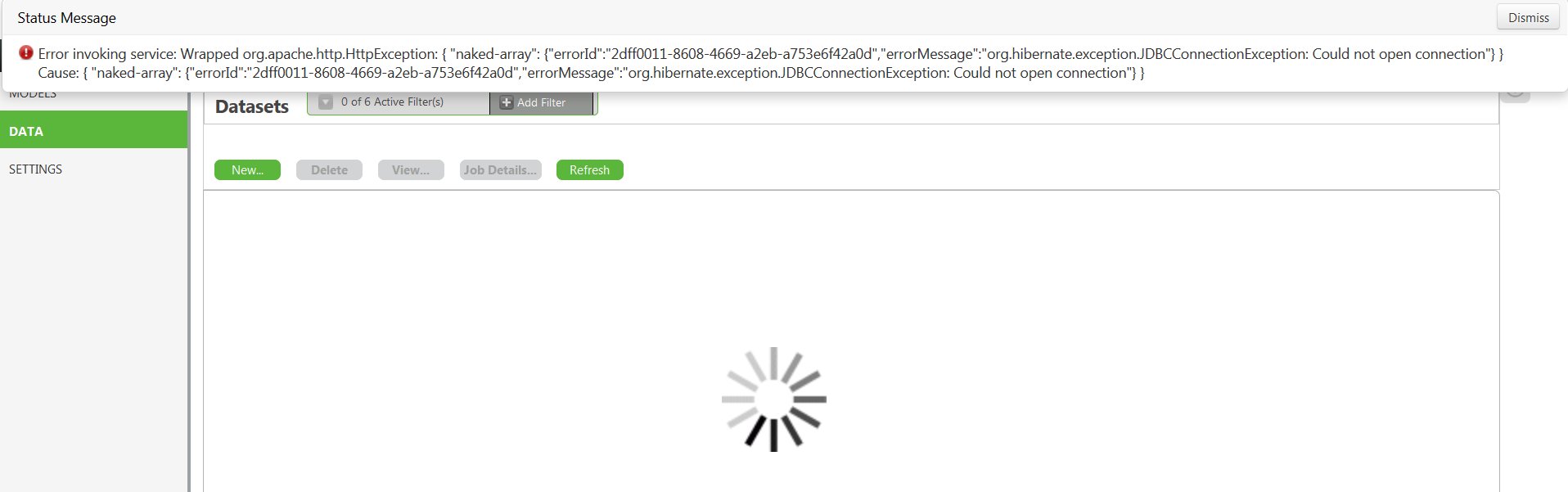

Thingworx Analysitcs Builder52.1 dataconnection problem
After build Analytics 52.1 Vmware successfully,then finish Thingworx Analytics Extension and Upload Thing ,appear this problem ,does anyone have problem with this ?

Hi Joe,
To Solve this issue, you need to configure the user management subsystem variables.  Here is a link to the page in the user guide that details how to do this.
http://support.ptc.com/WCMS/files/171266/en/ThingWorx-Analytics-Extension-Installation-Guide-52.1.pdf#page=19
Let me know if this resolves the issue.
John

Hi John,
Thanks for your reply,But I have already seen this guide. I am  step by step install and configuate the Extension follow this guide.Every step is smooth.so I don't understand why appear this problem in the end.The problem appear when I choose DATA,DATA in the Builder left navigation panel.

Joe,
Can you confirm what version of the Builder Extension you are using?
