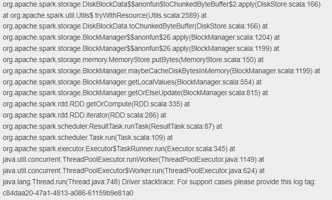

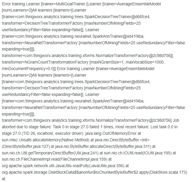

I want to create a predictive model with an ordinal goal variable based on a time series dataset of around one million entries. Unfortunatly the creation always failed with the error you can find in the attachment. Does anybody know how I can fix this problem?

From the screenshot you posted, the issue is due to an OutOfMemory error. This happens when working on large dataset.
Try the steps from https://www.ptc.com/en/support/article/CS294545 to increase the memory allocated to the workers
